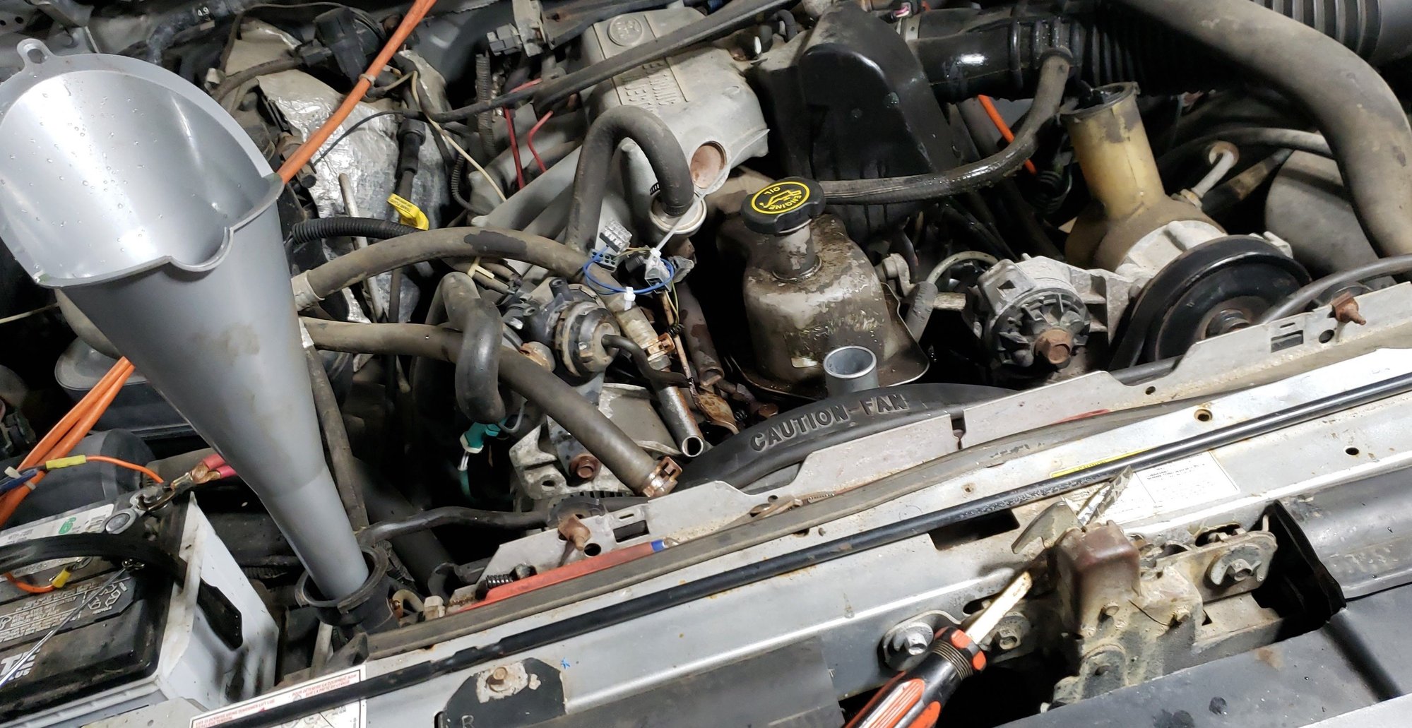

Reminds me of me
reminds me of me, this was about -20 or so and I GOT LUCKY and remembered I Had a mostly water coolant fill from doing some flushing a month before and forgto to follow up with a winter fill (Needed way more, but would wwait till spring) My cap had a lot of slushie ooze out when I checked, i capped it to prevent it from freezing instantly lol, plugged in block heater and then also gave it 2 hours, then started, it was able to flow thankfully, then once it was warm, popped that radiator drain
