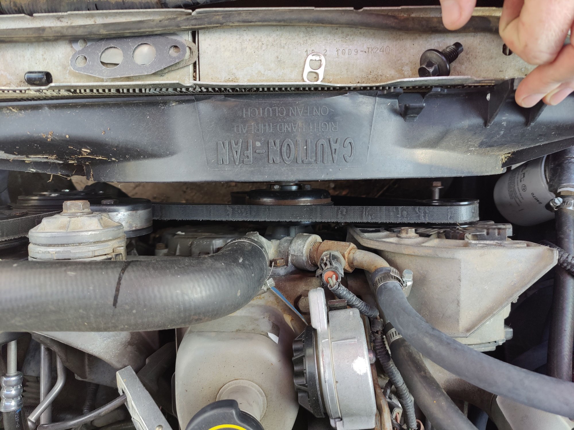

Can OP show us his water pump/fan/ engine? I have not seen a i6 without AC and am curious. #6 is what I have, a full shroud. I suspect the number provided before is what that is
Old Aug 25, 2022 | 05:57 PM
torq'ta 5 8's Avatar
torq'ta 5 8
Joined: Jan 2019
Posts: 5,076
Likes: 865
From: N.W. Alabama
real time pic

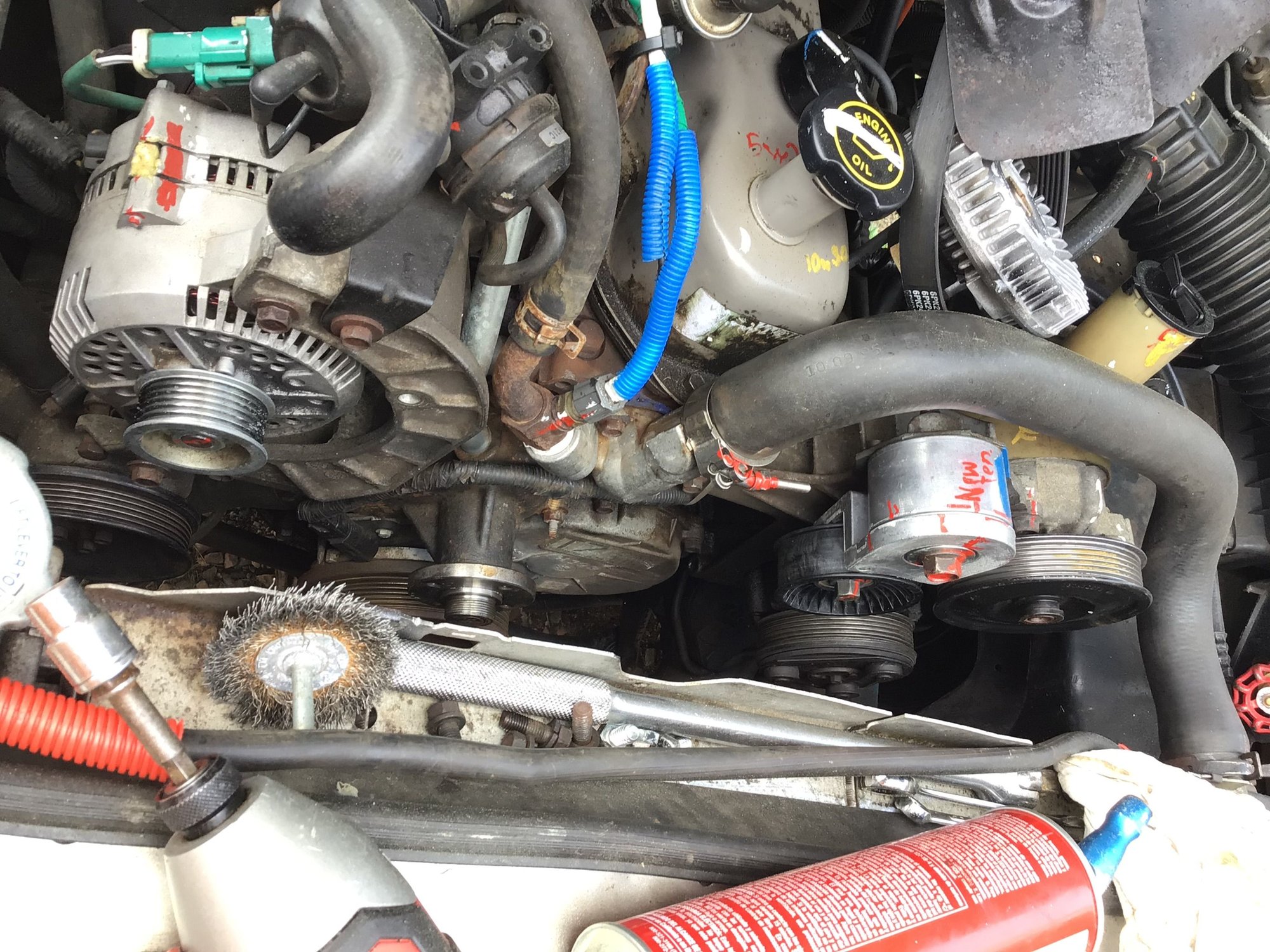

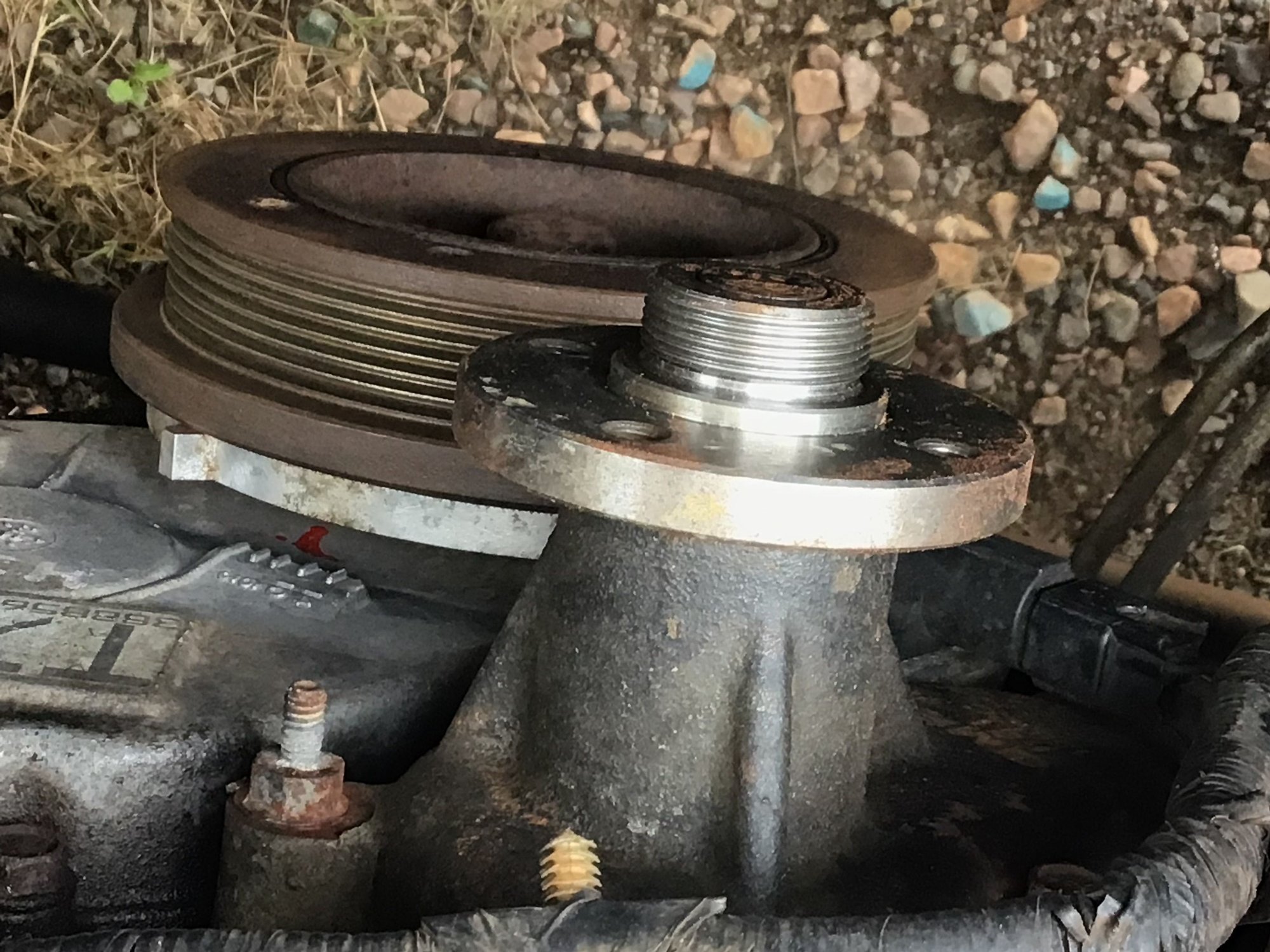

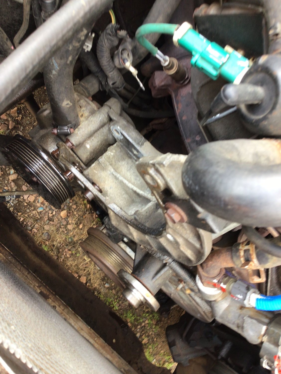

is the tensioner OE? Looks like your tensioner is due for replacement. Have you ever had issues with the belt breaking down on the "tread" , if so, look at your crank pulley and take a scribe to the grooves in an area. if you can dig out belt, I had the same issue.
Im not kidding when I say that the belt material put itself DEEP into thhe grooves and very well packed in too. I simply was STUNNED by how much the grooves were filled in with belt, and it appeared normal on observation. The black belt material masked the fact the grooves were over half filled in on each pulley almost.
The best tool I found was a stiff welding wire brush (I assume welding) that would be useful for clearing slag and stuff. The pulleys I had to go in the direction of rotation and reverse frequently to actually get under. If I had a scribe that I could find, In sure that would have sped it up. Took a long time. I also had to bump the engine over since doing it from below meant things falling in face and not the best reach
