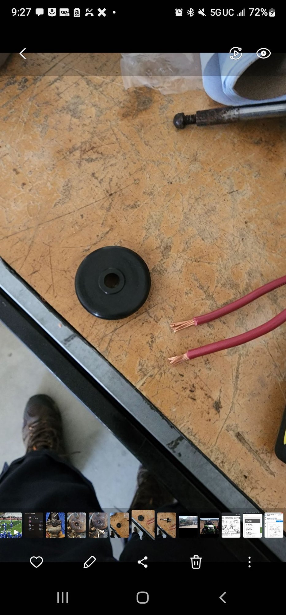

This came with new master
Rod with rubber piece from new MC. Is the spacer you're talking about?

I don’t see the piece I was talking about.
Looks like a little bullet shaped thingy. Often with a little rubber or ring to keep it in place.
Was that last picture of the booster supposed to be the picture of the insert?

Last picture is of rod with round rubber piece from new MC in the booster..

That rubber piece is just a dust boot and has nothing to do with the fitment of the rod to the back of the piston in the master cylinder.

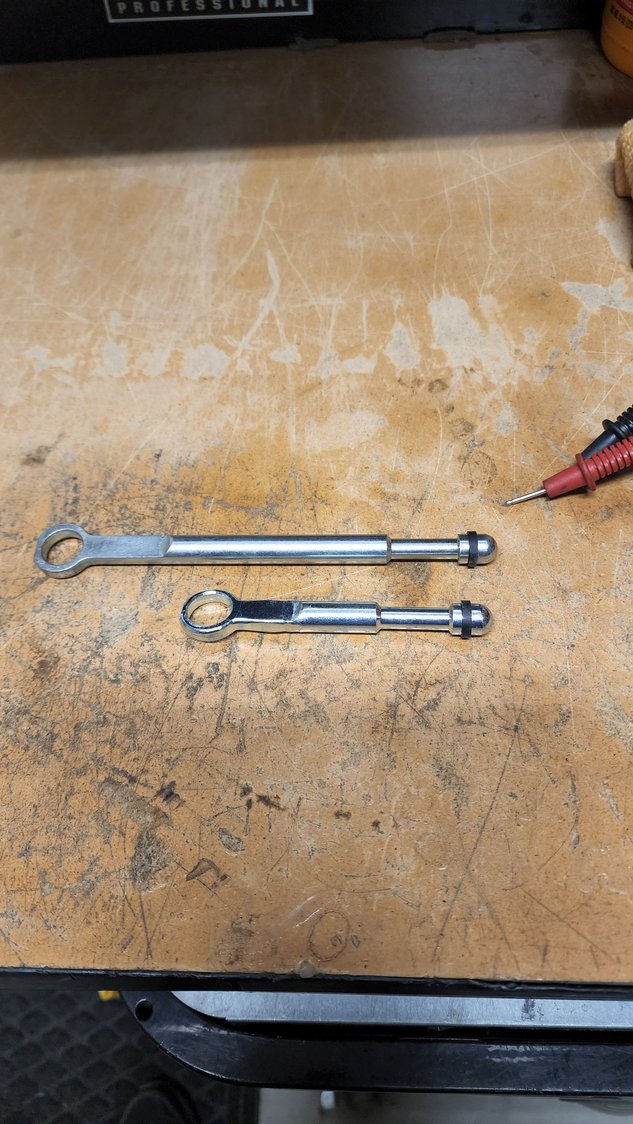

These came with the new MC. Are these the bullet rods you were talking about 1TonBasecamp?

No, those are standard pedal rods for different manual brake setups without a booster.
The ball end with the black clip snaps into the deep well of the master cylinder.
A deep well that might not be compatible with your booster rod without the spacer I was talking about.
The bullet thing I was talking about is approximately three-quarter inch long with a pointy tip at one end that goes into the master cylinder and a concave outer end that the booster rod fits into.
Since the brakes don’t work you might as well remove the master cylinder from the booster and have a looksee at the back end.

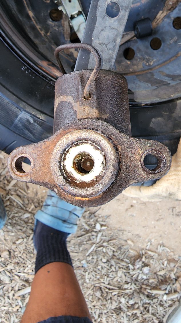

Pictures of old MC
