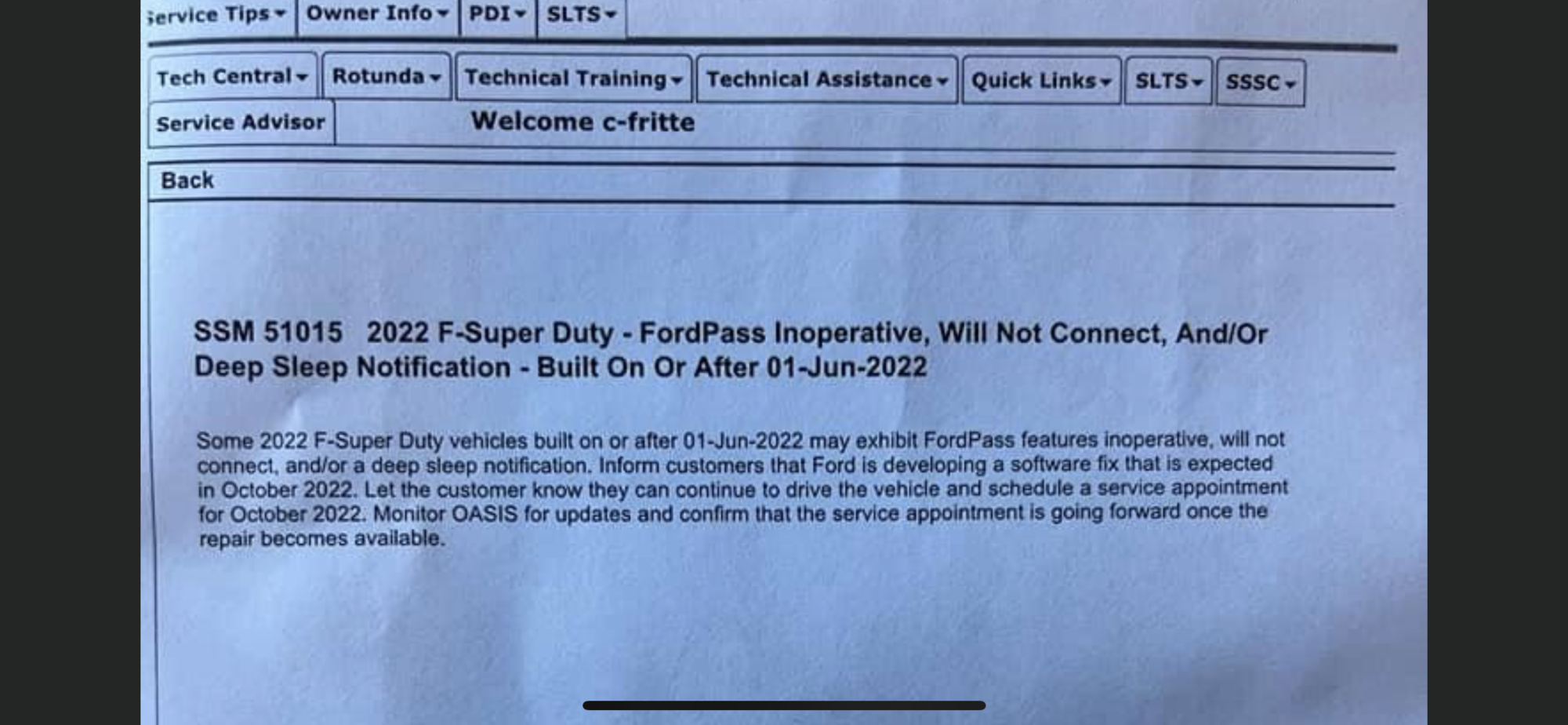

Old Aug 24, 2022 | 07:01 AM
Hybryd40's Avatar
Hybryd40
Joined: Feb 2022
Posts: 64
Likes: 81
From: Fort Wayne Indiana

Old Aug 25, 2022 | 07:37 AM
Readgriff's Avatar
Readgriff
Joined: May 2017
Posts: 217
Likes: 8
From: Michigan
Hybryd 40
Where did this buliten come from I asked the service dept about this and they new nothing about it.
So Im trying to figure this out I keep getting messages on FordPass.It keeps going deep sleep mode.
Thanks
