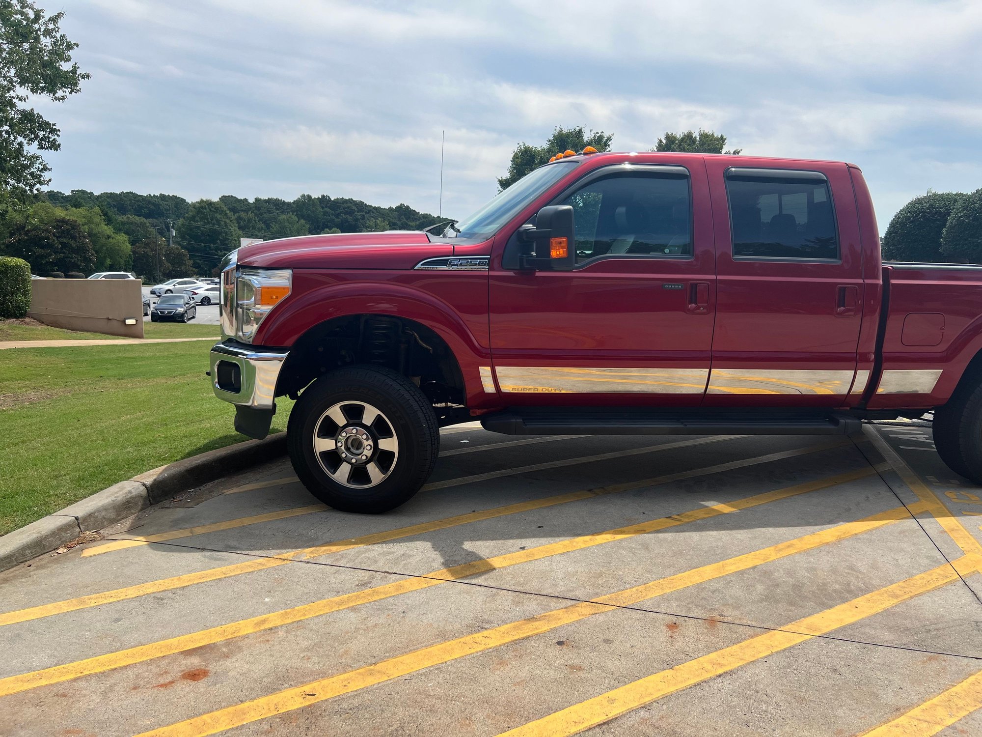

Top picture is a picture I took when he first got the truck. You can see with the snow plow springs (I believe they are the 5,600lb springs) it sits a little off level, with the front about an inch or so high.

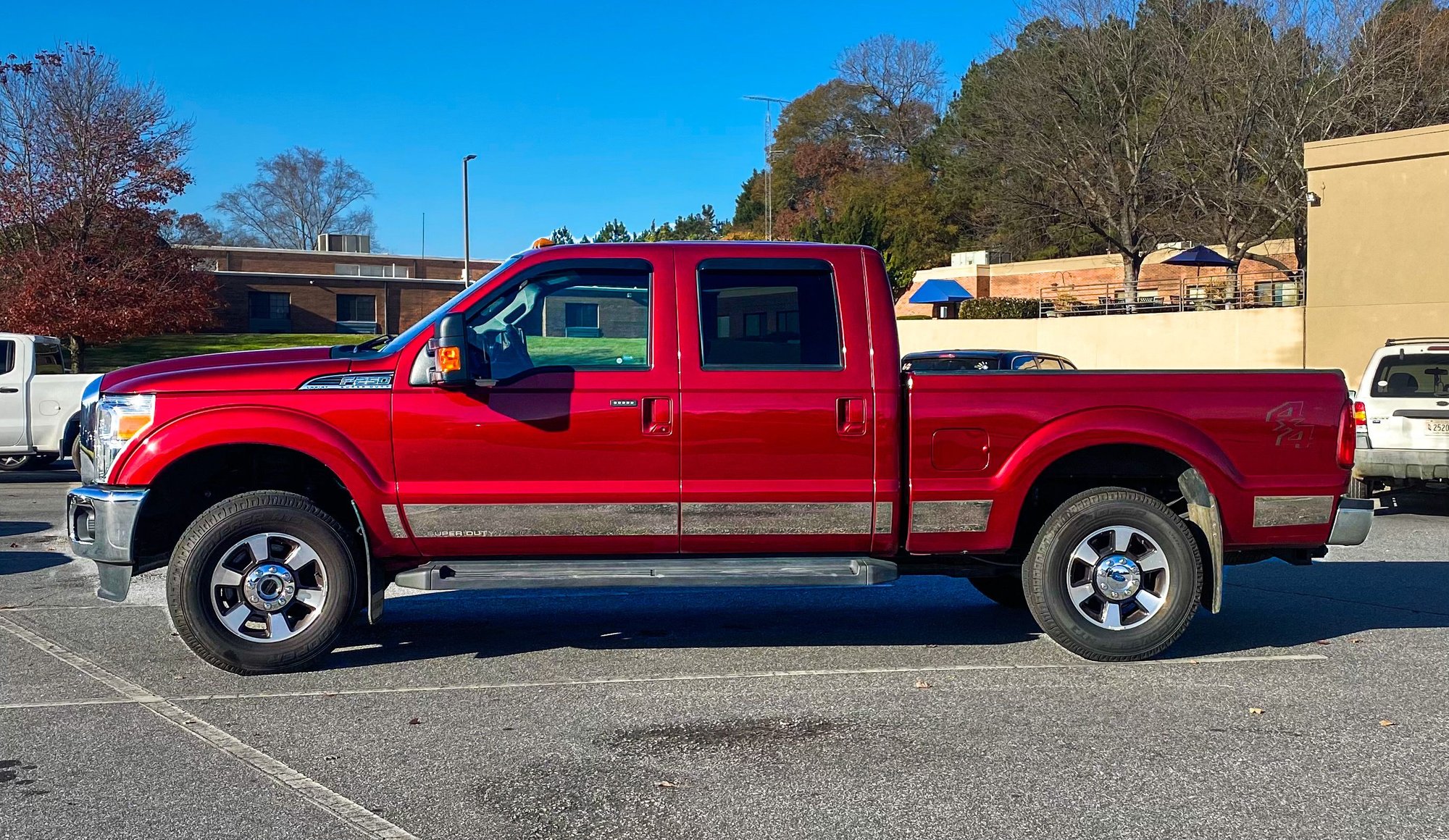

Bottom picture is with the Dayton springs that were supposed to raise the front 1-2” from a stock setup to level it out, but provide as close to stock ride as possible. You can see it now sits WAY uneven with the front even higher up.
