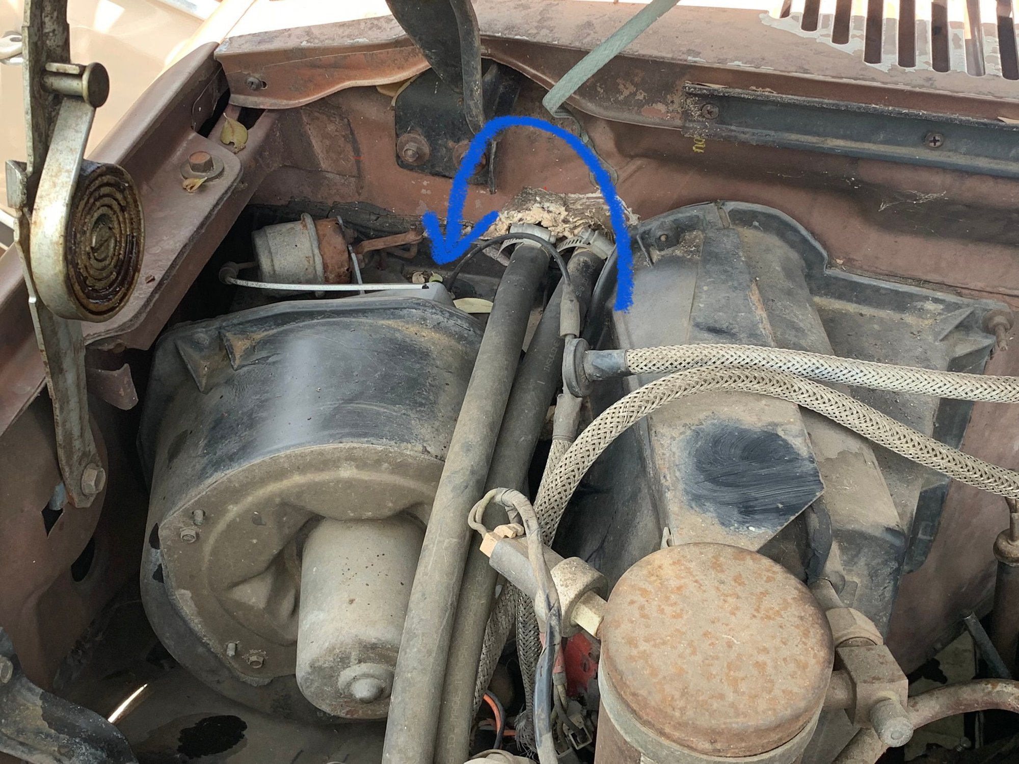

I believe Dave is correct in that, the little black hose dives down into the AC stuff before the firewall as shown…
on that note… the AC has never worked since I originally got the truck in 92ish and I am pretty sure I threw the compressor away about 25 years ago… or the smog pump… or both. What kind of bear am I trying to wrestle if I attempt to get it working?
and how the %#€# do I get this thing off!?! I can’t pull it off, can’t get pliers on it, a little flat head won’t slip under it…

That is one of those speed clip retainer things. You will have to get a small screwdriver and work under it, and then a bigger one. You will end up mangling it and breaking the clip to get it off.
Same as these but without the slots.

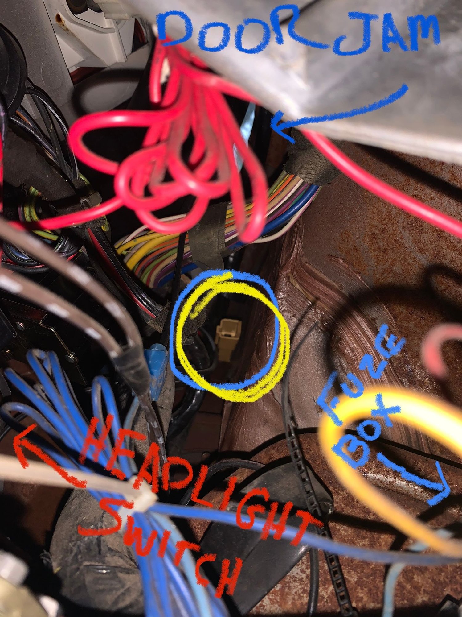

Mystery #6
This one isn’t terribly important I’m guessing, but I keep finding connectors around this truck that are not connected, but clearly have a purpose… I noticed it when I was changing the drive side floor light and pushing the main wire run back into the holder…
There is a little tan/light brown connector, it sits behind the dash against the firewall/side basically behind the far left air vent from what I can tell… any ideas?

The trucks will have a bunch of unused plugs this is normal.
It is for options your truck dose not have.
Look behind the brake booster you will find 1 or 2 there for options not on the truck like under hood light and trailer lights.
I say if everything works dont go looking for things to fix LOL

If that plug is on a brown wire, that is the power feed for the optional roof marker lights.

I knew there was a wire plug there I just could not remember what it was for at the time.
If he was to pull the dash pad off and did not have a clock there are wires there for it.
Easy add on just plug it in and cut the bezel or get a clock bezel.
I know I have plugs for under dash lights and 1 day I may add them to my truck.
Your a boss Franklin, talk about obscure… lol
when looking through the original sales materials that someone had posted elsewhere, from what I can tell, this truck had every possible option except power windows for some reason… and roof lights it seems now, although I don’t think those were actually on the factory option list for the F150…
Dave, your right… I believe there are a couple plugs behind the brake booster as well I have noticed and probably would have posted those on here at some point 😂… I’m not a fan of having mystery connectors just hanging around…. Especially if one day my daughter will be driving this and one of those connectors could be something safety related .
