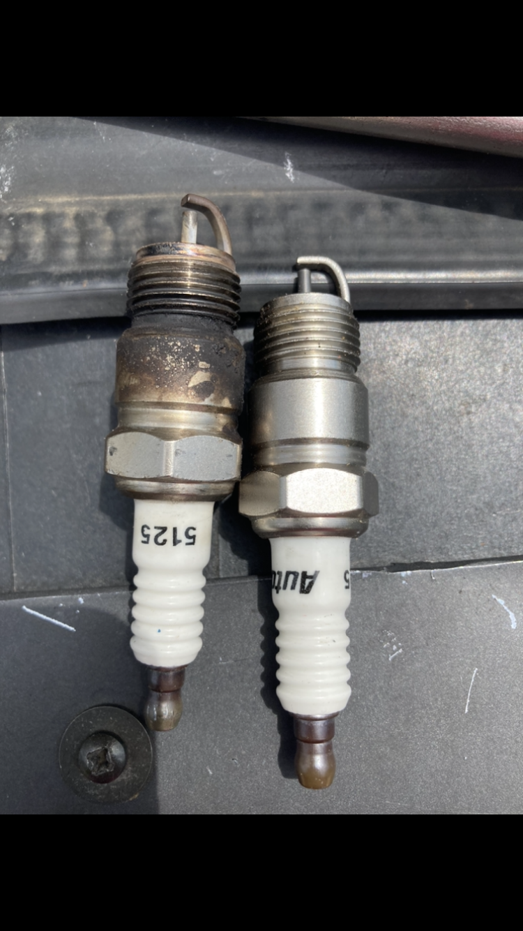

Here is the autolite plug his engine needs stock 1995 OP, does your plug cross to that number? and does your plug look like the left one? Your head rusty? My threads were rusted and not threading nicely and my plugs werent sealing and they would rattle loose!!! I used wire drill attachment, carb spray, and then towels to clean up the seat. I chased the threads with tool
i got 5 out of the 6 motorcraft spark plugs, its still missing and cutting out but i was actually able to get up to 60 mph. Im going to get a 6th motocraft and see if that does anything. it only sees to be mising/cutting out under heavy acceleleration. if i ease into it it dosent do it and it seems to want to do it more around 30 mph vs any other speed.

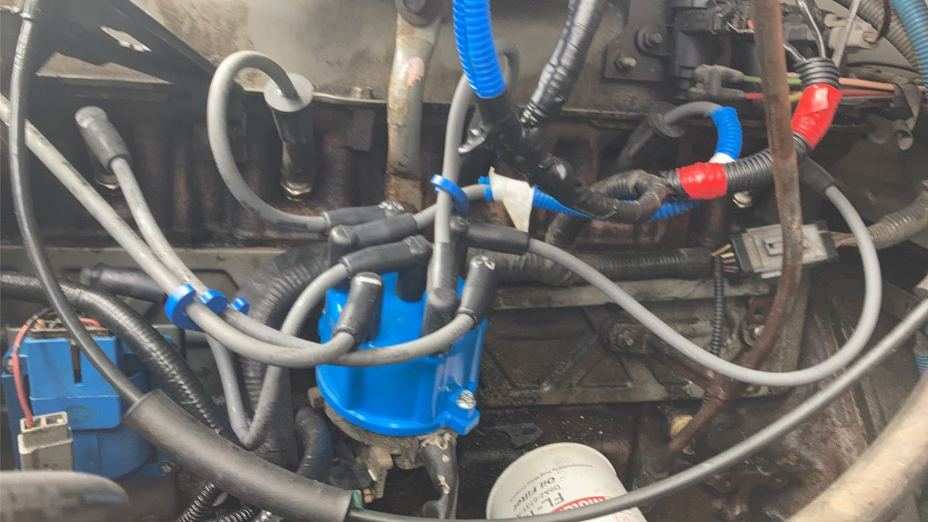

you did not in anyway answer what I sent LOL
Show us your wiring, distributor cap etc, show that
