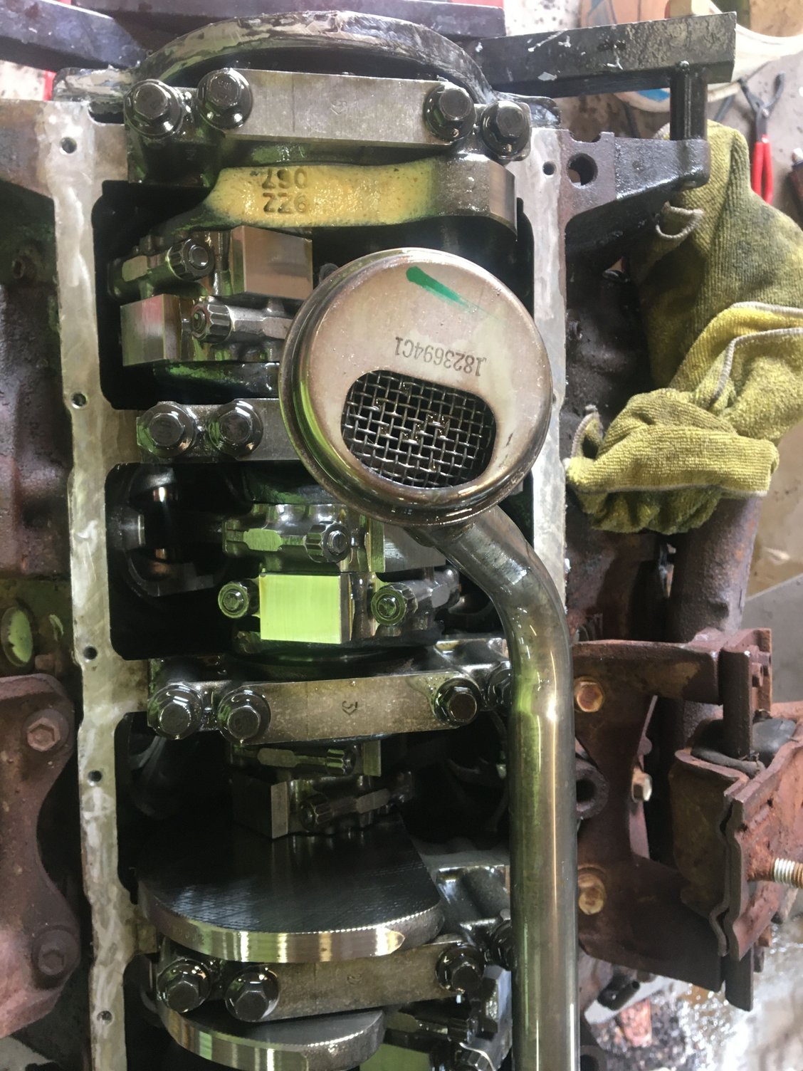

If it made it down into the pan, it may not hurt anything. Pickup has a screen. But if it stayed in the cover somewhere, not good

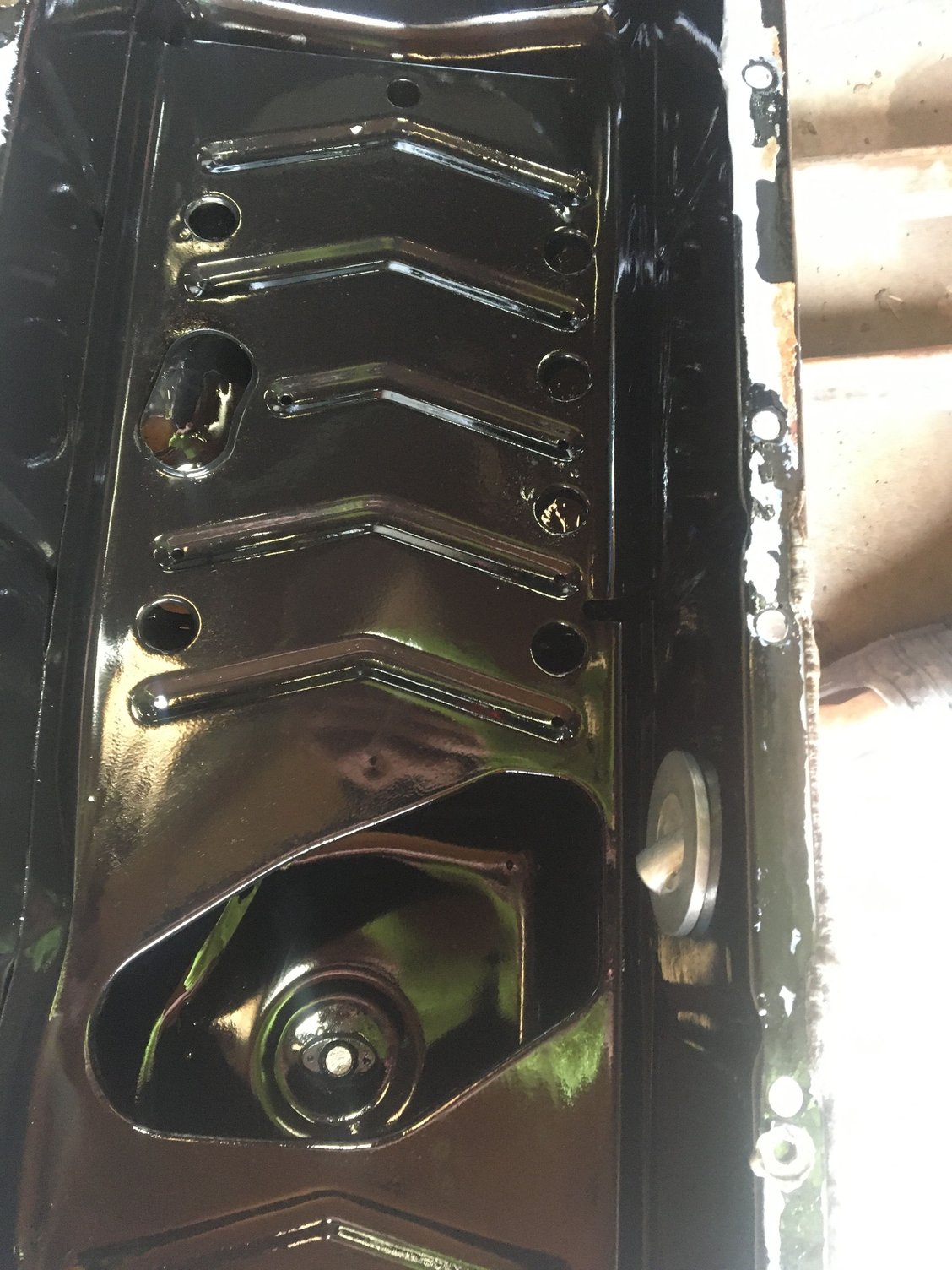

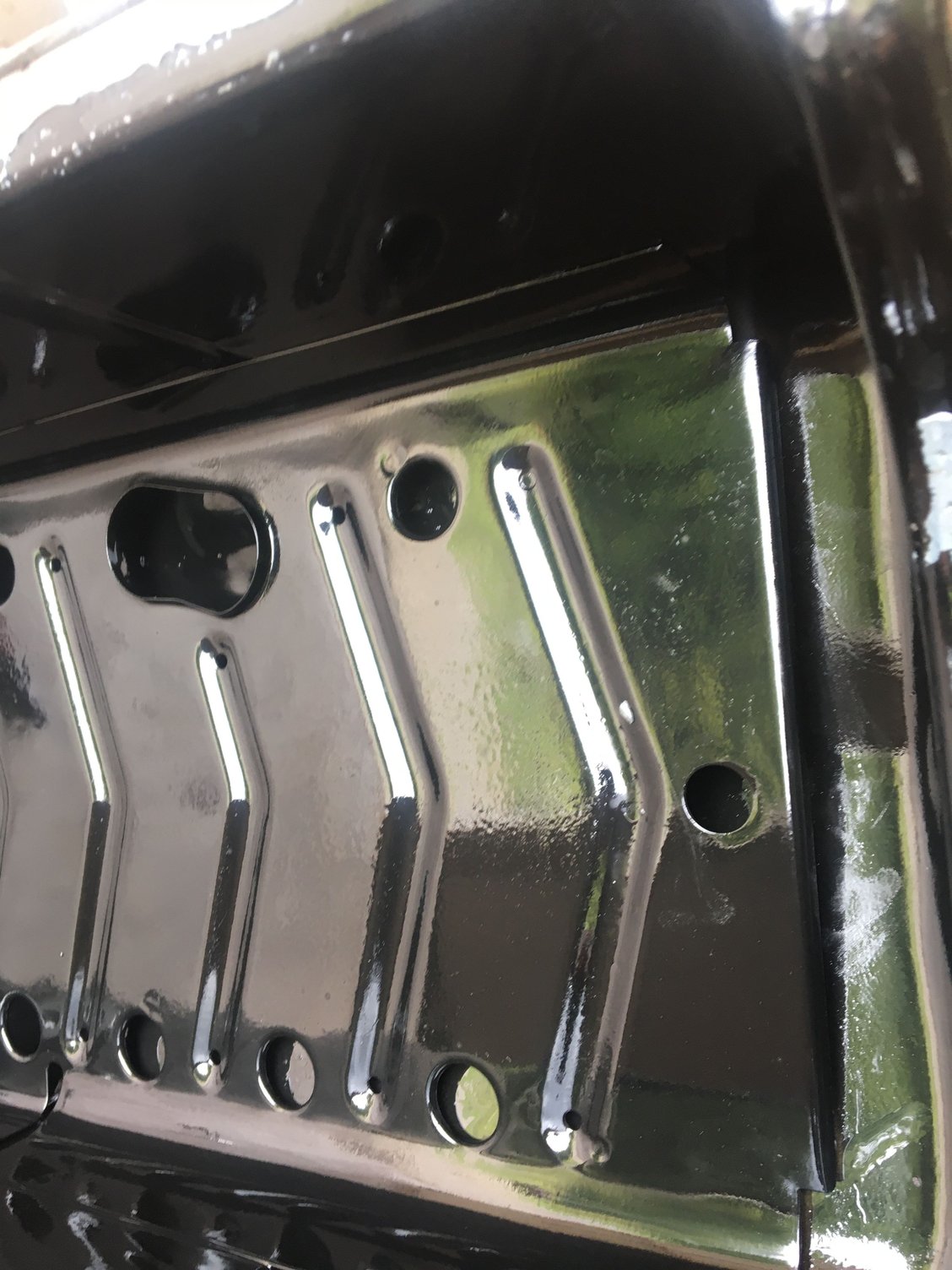

it was stuck between front cover and something a few inches down below the lower half of reservoir I tried to get it with safety wire and it fell and i heard it hit the pan bounced once then stopped.... was thinking i could try and get it to the drain hole be flushing it with used oil i just removed. Then try and possibly get it out drain hole ...most likely wishful thinking...

If you know it for sure hit the pan I wouldn't even worry about it. It should stick to bottom of pan with oil in it.

If it is 1 1/8” you wont ever get it out the 1/2” drain hole. Have you cranked at all since it fell?

Of its in the pain it will be fine. Put a washer in a container with oil in it and try to get it to bounce around. It will stick to the bottom. There is a dipstick repair kit on the market where you just knock the inner piece down into to oil pan and it lives there so you don't have to remove the pan.
