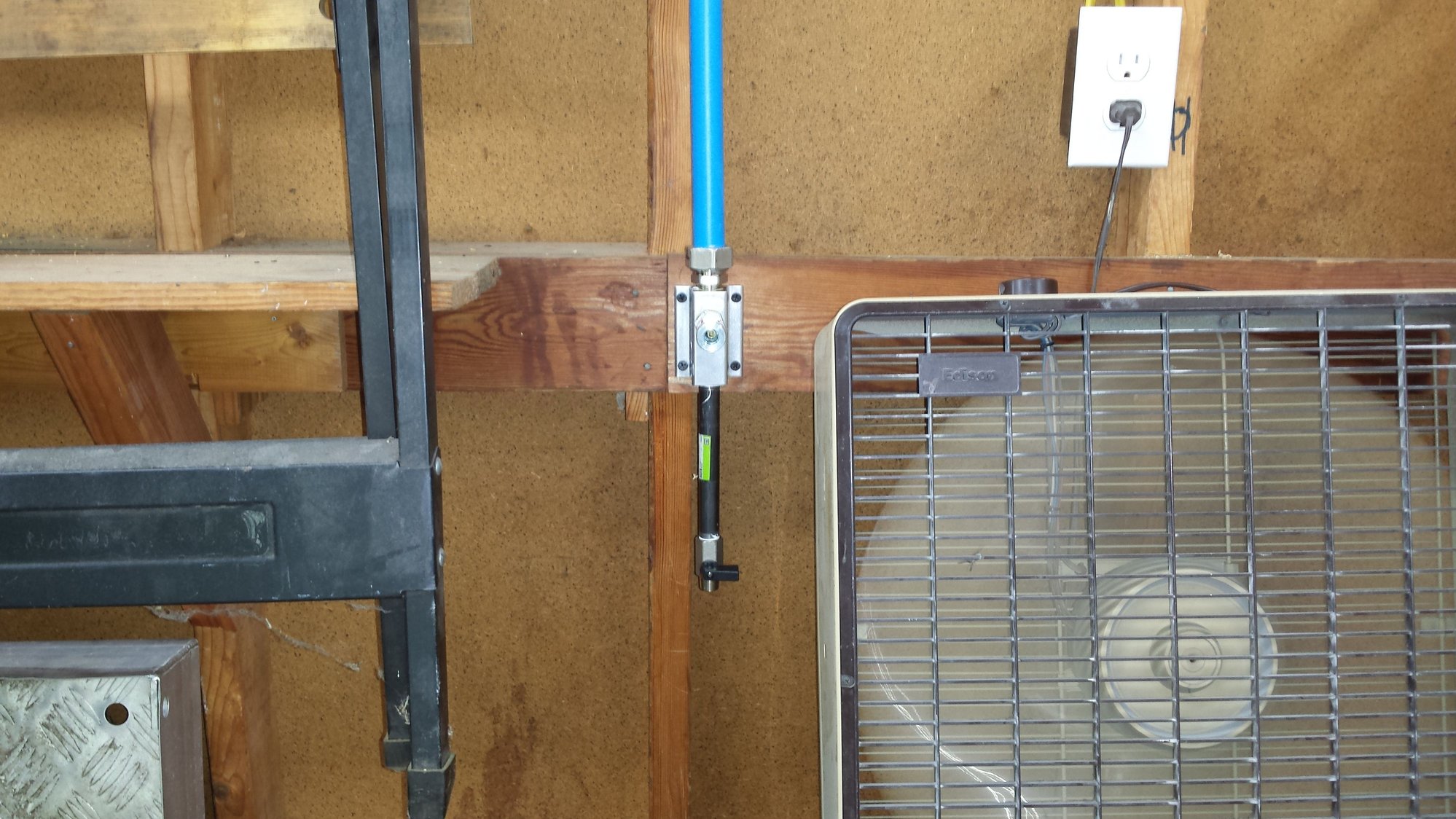

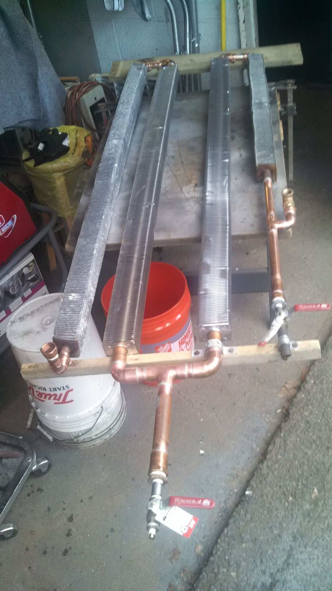

What will you be using for a dryer? The web has all kinds of DYI dryers.
I went with base board fin tube with a few fittings and 2 drip legs to fit where I first had it in a small 1 car garage.
When I moved I took it and the compressor above to my new 2+ bay home garage / work shop.
It is right out of the compressor to the dryer out of the dryer to my air pipe system that runs around the top of my garage in a loop with 5 hose drops.
1 drop at each head of the bays, 1 on each side of the garage (work bench is on 1 side) and 1 between the 2 bays on the door side.
When I spray painted my truck I had to set a box fan in front of the fins to help cool them to condense the water out of the hot air.
Also each hose drop has a drip leg but I have never gotten any water to them.
Dryer air comes in on the left and out the right side.
Compressor, dryer, piping and 1 hose drop w/drip leg
Dave ----

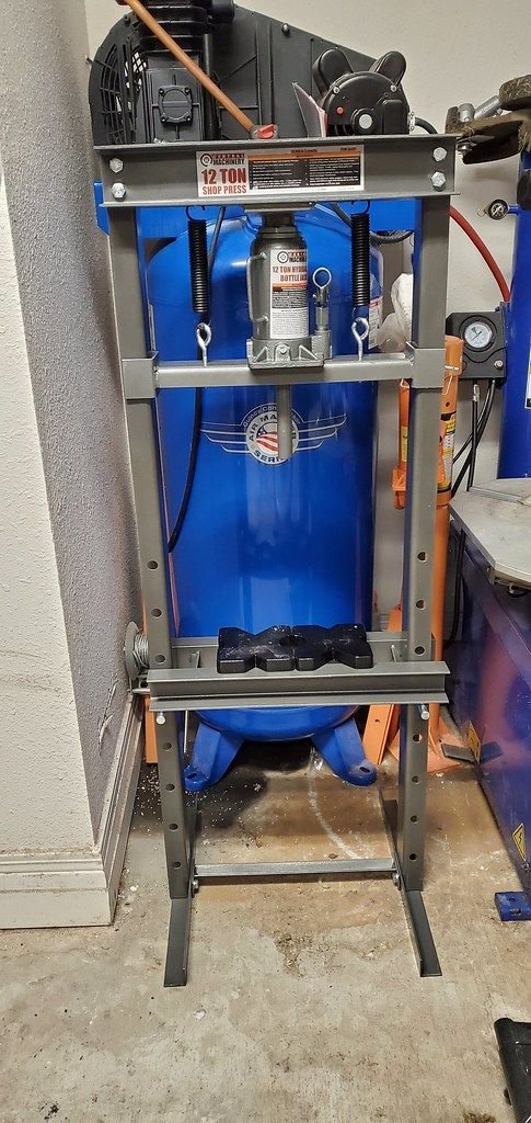

I bought a Quincy back in 2013 and it's seen very little use over the years, it wasn't long after warranty was up the damn thing started leaking oil out the bottom, found the gasket for it via google. I'm sure you could find and order a new pipe if you don't wish to jury rig it. Don't know how yours is set up but on mine that pipe is front and center and my ocd wouldn't let me do anything but use a Quincy or equivalent pre bent part. I wasn't going to also buy a pipe bender just for that one thing.
Excuse the HF press up front. Oh and while I went looking for a press at HF I took a walk down their compressor isle and they have Quincy clones fresh out of China I'm sure and they looked identical in every detail except they painted them black.
Well after I got the gasket and fixed the oil leak, one day I went to fire it up and that little switch it comes with stripped out, had to order another one of those but luckily it seems to be used on damn near all brands of compressors. You can see the switch at the bottom end of the pipe.
Had it not been for Quincys reputation and (specs mainly), I would probably never buy another, at the time it met every spec requirement to run my blast cabinet, tire machine, and misc air tools and wasn't too bad on price. Still made in the US and that was also key to buying but damn the China parts they must be using now is disgusting.
