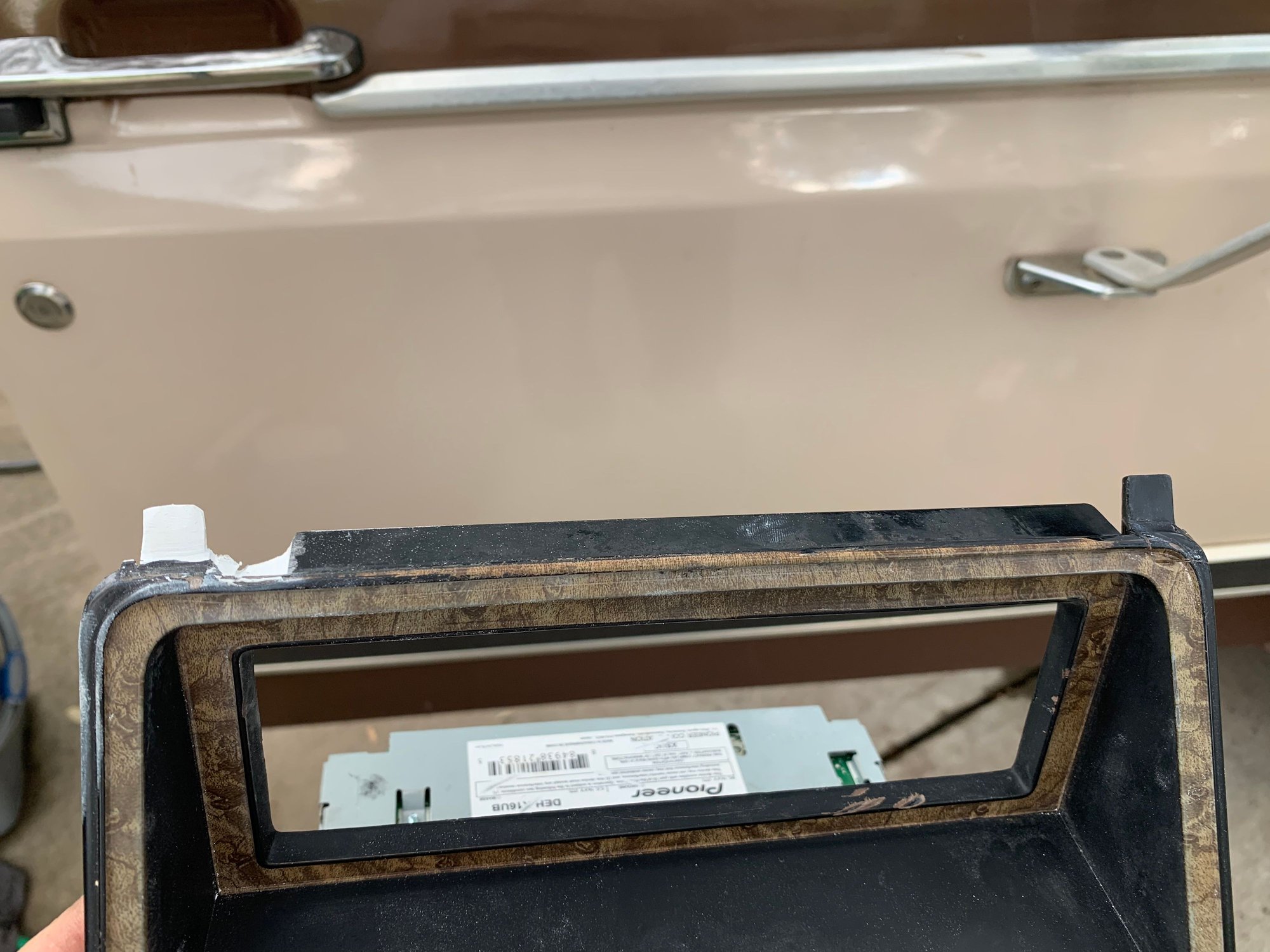

Rebuilt the bottom tab on the radio bezel… for the second time. This time I used my brain and held it up to the dash, then sanded off the excess… for a nice fit. Then painted it black… the JB weld plastic stick has been surprising effective and fairly simple to use so far… we will see if it holds up in the long run.
The white in the gap was where my first attempt was 🤦🏻‍♂️

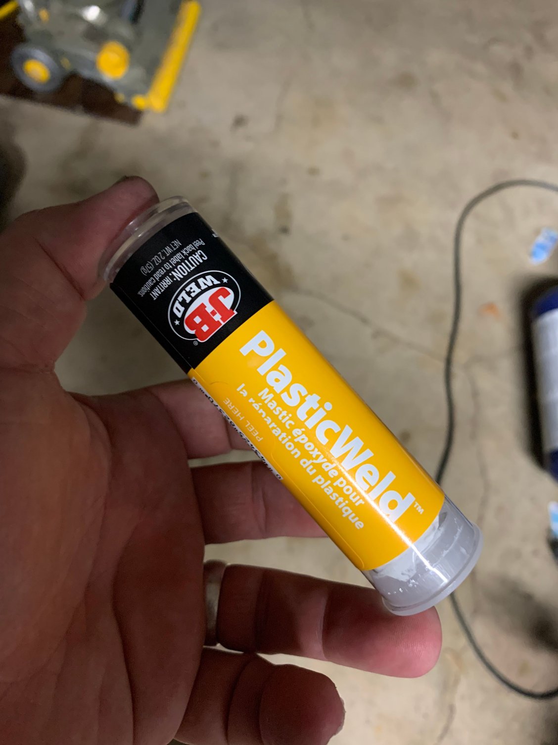

Do you have a part number for that JB Weld plastic stick or a picture of the package.
Where did you get it parts store or hardware store?
All I have seen is the 2 part epoxy mix stuff but also have not been looking for it either.

I got my stick on Amazon after I went Lowe’s and they had the wood weld, metal weld, water weld… but no plastic weld.
I was in my local NAPA store today and they had 5-6 different kinds on the shelves, so maybe other auto parts stores will have them as well, maybe Walmart as well.
