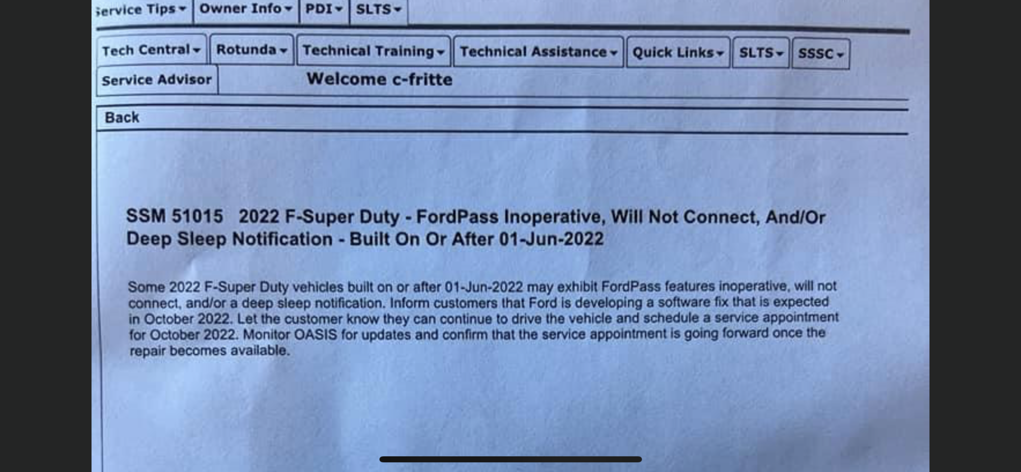

It's a known issue with 22 trucks built after June. Ford is working on a software fix that is supposed to be available in October

Posted on another site
Thanks for posting. Good to know they are working on a fix. What sucks is I have to wait 2 months for this fix and some folks probably a lot longer than that. Yesterday, my Ford Pass worked immediately after I shut the truck off even though I received a message that it had been disabled. 10 mins later, not working. Hopefully the SW upgrade will fix it. Very frustrating.....
