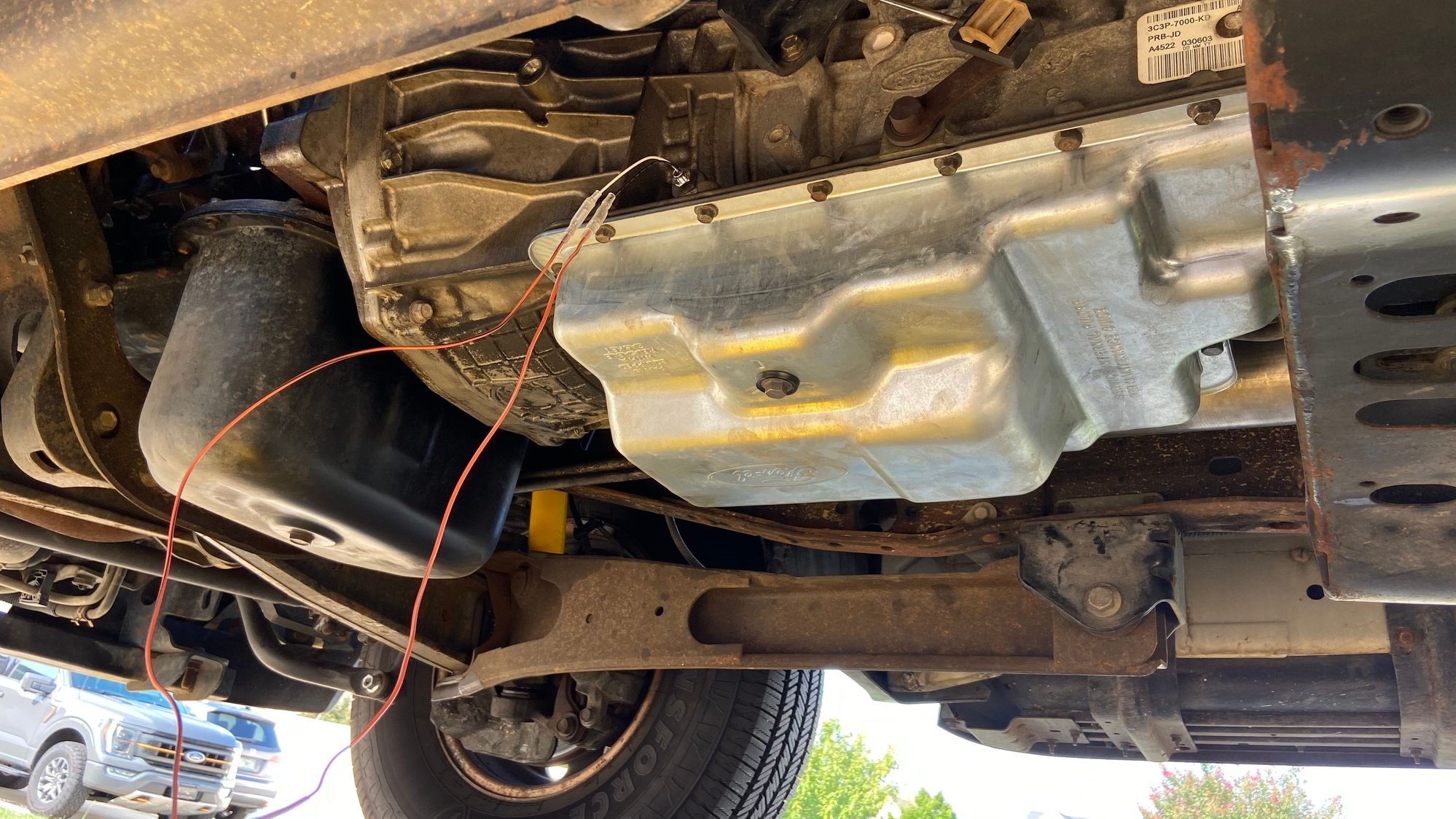

Just wanted to update this.
I went for it and started by making a jumper cable from the extra external trans harness from a F250 I bought off eBay. I depinned the 2 TFT sensor wires and stripped them from the harness. I swapped the pinned ends from the PCM side connector and the other ends to a GlowShift temp sensor I bought and installed in the pressure test port. 1/8”x27. With this setup, truck runs just like stock. I did this to troubleshoot a suspected bad internal wiring harness. It worked great. It’s also an alternative to relocating the TFT sensor to the outside of the transmission.
NOTE: This specific GlowShift sensor runs a little higher (hotter) than the stock TFT sensor by about 15-20 degrees. I knew this going into it, but the purpose was to troubleshoot a bad internal trans harness and to see if this worked without any other “side effects”. I will be trying to find a closer range sensor to swap out.
