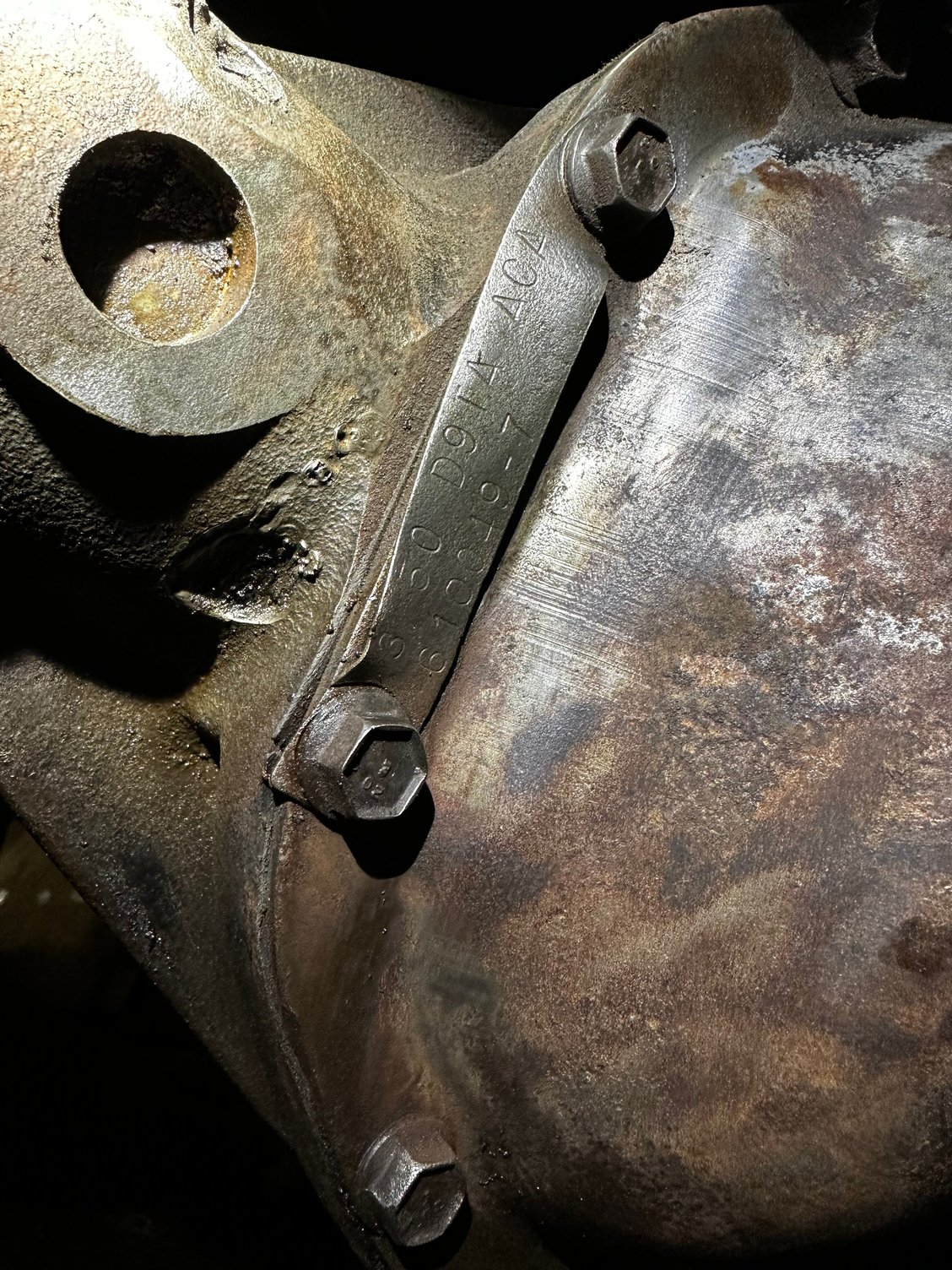

Front diff tag decoding
Sorry I hate to be that guy but can anyone decode my front diff for me? In case the pic doesn’t upload it is 3.50 D9IA ACA 610049-7

Dana Spicer Differential Tags
Dana Spicer B.O.M. Numbers
The Bill of Material (BOM) number is used to identify Dana differentials. The BOM will identify the model number, the gear ratio, the type of differential, and all component parts. Traditional BOM’s are 6 digits followed by 1 or 2 digits and start with the numbers 60 or 61. On some tags, the first 2 digits don’t appear on the tag, but they must be used to identify the axle. For instance, you might see 5561-1 for the BOM, but the 60 has been dropped, and one would need to use 605561-1. Later BOM’s may start with the first 3 digits of 200, but these are typically not dropped from the tag.
*** The B.O.M. Numbers stamped into the long tube of the axle housing are often faint and hard to read. Using a metal scraper will typically reveal the numbers most easily. Cleaning with a wire wheel is not recommended as it usually makes the numbers harder to see ***The “Dana Expert” website is no longer available. However, the Dana Aftermarket Media Library can be used to identify all aspects of a particular axle using the Bill Of Materials number.
  1. Navigate to the Dana Aftermarket Media Library
  2. Enter the BOM number in the Keyword Search field (top left corner of the page).
  3. Click on the resulting literature link
  4. Search within the document by clicking on the Magnifying Glass at the top, or by simply using “Control-F” and re-entering the BOM number.
