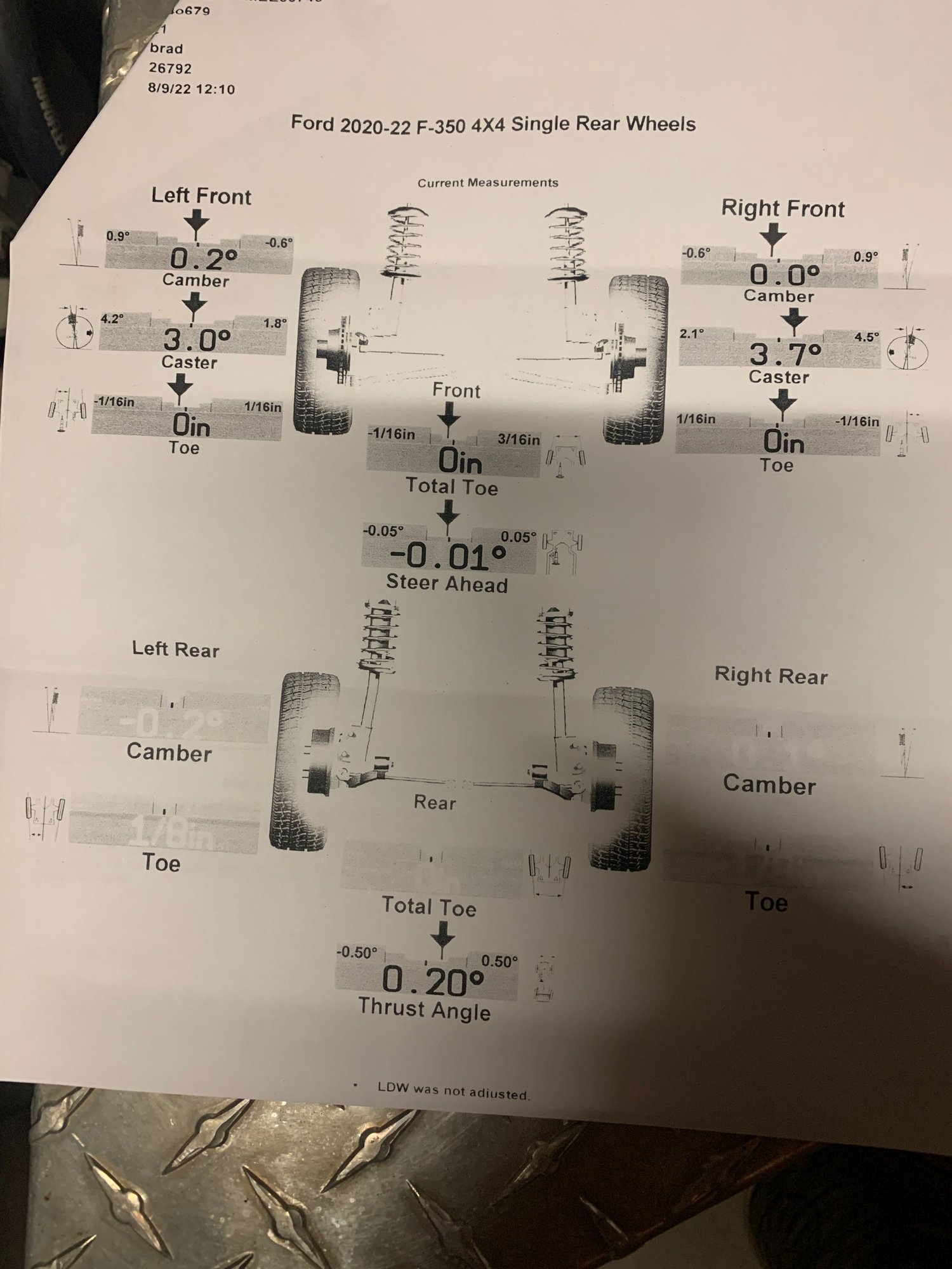

Looking for some feedback
2021 F350 CCSB 6.7 4wd
truck has 1.5 level, 295 65 r20 open country at3 and bilstein steering stabilizer
I added 2.3 and 2.6 shims as recommended in here
truck seems to want to drift left on most highways, slight steering wheel feedback over bumps etc
had it aligned and rechecked. Seems to be within specs
can anyone take a look at my alignment sheet and give me some ideas. Does it need more toe in? More caster?
Thanks !

A vehicle will drift to the side with the least positive caster, just like you have there.

how do I add more? 2.6 shim in that side too?

The SPC 2.3/2.6 combo is used to compensate for road crown allowing you to track straighter for longer

I had it aligned after level and caster shim install and it pulled, tried the new damper and rechecked the alignment. All within spec. Drives decent just annoying left pull. I may play with the toe a little and if that doesn’t feel better try and increase my caster a little more. How..I’m not sure yet

I have that setup currently yes…it pulls left which makes me think maybe I don’t have enough caster on the drivers side. How can I increase it a little bit more

right, but if you tell them it's pulling they should know what adjustment to make to solve that and still keep it "in spec" IMO ford spec sucks, hence the tons of death wobble threads related to ford oem alignment. is the alignmetn tech over compensating for the crown in the road possibly?

I know little about alignments, can the tech add caster to driver side without changing shims?
