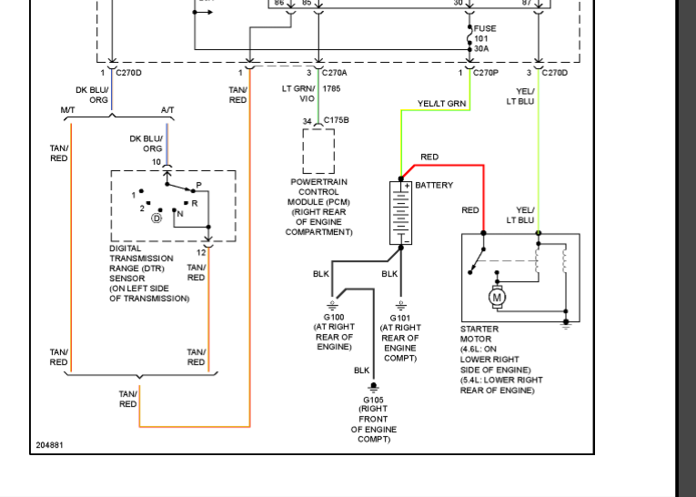

Throwing parts at it is not the answer . You need to use test lights, you can prewire a long test light wire to see where you are losing signal.
. Find out first if start relay sending 12vdc positive , if not the start relay is not picking up .
You can decide from there whether you have a failed starter or a failure to get start relay picked up. A test light is very visual , easier to see than a voltmeter . Use a lead from negative battery terminal for reference to test light ,that way you are not depending on a bad body ground . Of course if you are looking for a ground signal you can use positive battery terminal lead for reference to test light . If you are worried doing that you can put a small fuse holder right on battery pos terminal .

You just need to see if start signal going down to starter solenoid when it fails . Wire in a test light , bar loose connection on starter that would mean starter solenoid intermittent . It was probably a reman starter anyway , we know how little they do on reman stuff . Like the man says new doesn't mean good . But as far as the start circuit goes there is other stuff that could be intermittent that can be found with your own homemade soldered test light looking for loss of signal during failure . One is your shift interlock under truck .
