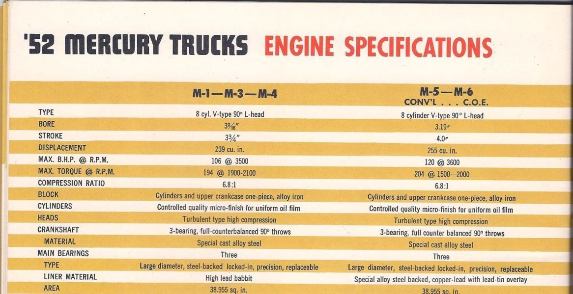

Only the 1952 M-5 and M-6 Mercury Trucks were available with a 255 engine, all others with flat-V8's were 239's. Mercury Cars all had the 255's, from '49 - '54 (in Canada).
So is it possible that we may have a Mercury car flathead in our '48 pickup because it certainly doesn't have the original engine?
