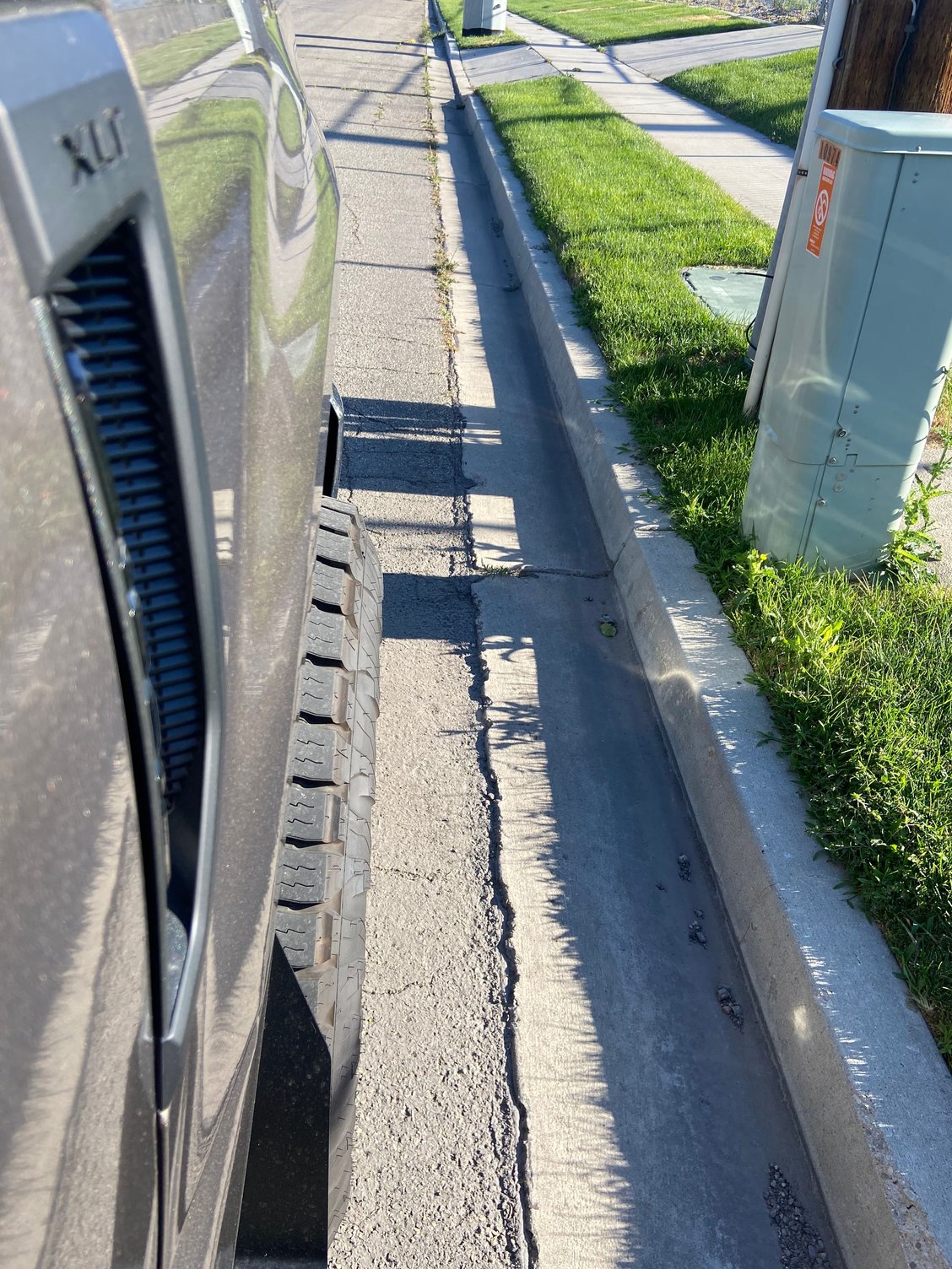

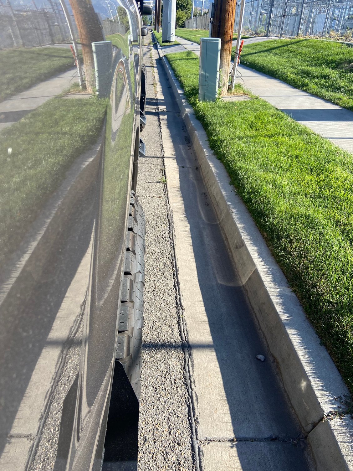

These are 18x9.5” +12 offset
Front
Rear
Front
Rear
If those are actually +12 offset, my brain is fried. I thought the higher offset number moved everything further inward. Those stick out much farther than I would expect with a positive offset.

Could be the tire also. Those are 37x12.50 Toyo.
Factory offset is like +44, so everything subtracted from that moves the wheel/tire out. I’ve seen some +20 offset that are pretty much tucked still. What’s the options for offset on the wheels you want?
