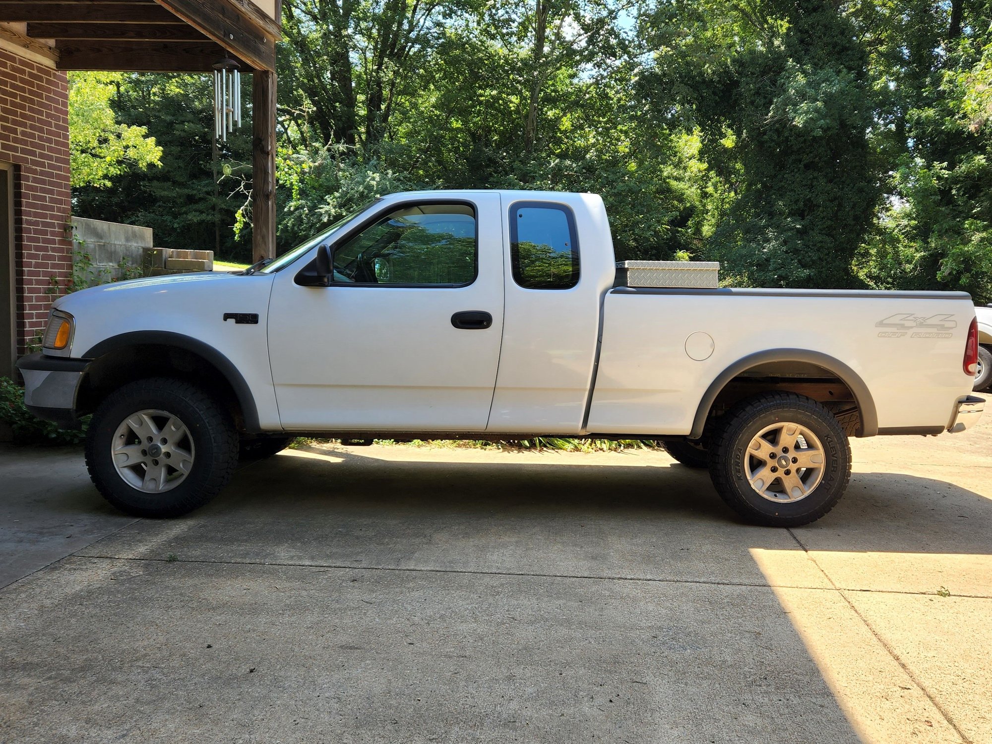

Hello all, I recently found what I consider a gem of a truck in the body style that I love. A 1997 F150 extended cab 4X4 with the 4.6 V8 and a 5 speed manual and the truck is close to mint. With that, the only real upgrade I wanted to do is change the the gauge cluster out because for whatever reason it did not have a tach. Bought one from the salvage yard after researching and plugged it all in (easy job) and everything works just like it's supposed to except my speedometer is now 6-7 mph off at 55 mph. I am running a 265x70x17 tire where the factory tire is 235x70x16 but I don't think that would make a 7mph difference? I know this year truck the speedometer is gear driven in the transfer case and maybe other places but I wouldn't be sure where to start. Nothing mechanical in the gauge cluster so there are some electronics controlling some of this. I have used Forscan for other things but I wanted to reach out to some of the experts here and get some suggestions. On another note this truck has a build date of 02-96, I had no idea the produced them that early before 97 and sold the square body along side the new body style.
