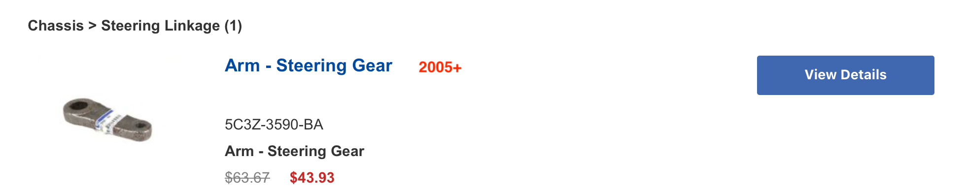

So far, this is just a copy of the Facebook page. And what has not been addressed is if the '03 and '04 are a similar bolt-up for the pitman arm, which is a different part number than the'05-07 trucks.
Were different pitman arms used on the early and late 6.0?
Which makes me wonder: the guy orders a 17-19 gearbox, 08-16 lower and upper steering shaft, and 11-16 pitman arm (which obviously fits the newer gearbox).
Seems a lot of things fit beyond other years of manufacture .
