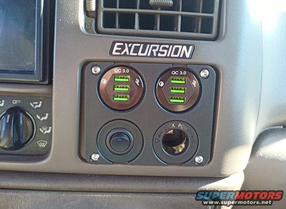

This thread just reminded me of something similar I did and lost track of. I was dealing with a crunchy dash bezel and went this route.
Now I have usb for days, a power port just in case, and the switch is there to turn the panel off when not in use.
That spot isn't really square, more of a trapalellazoidagram with a curved surface. The panel I used needed some trimming top and bottom to fit.
