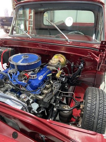

Wiring - Finished!
Finished installation of the complete wiring harness this morning. Many thanks to all who answered my posts during troubleshooting. All in all, I would do it again now that I have learned some good (and bad) things about harness installs.

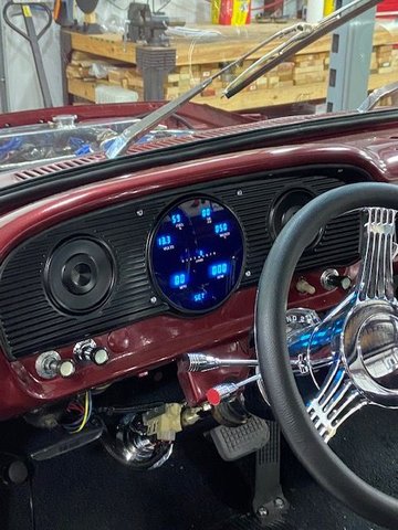

Instrument Panel Installed
Instrument panel and gauges also installed.
