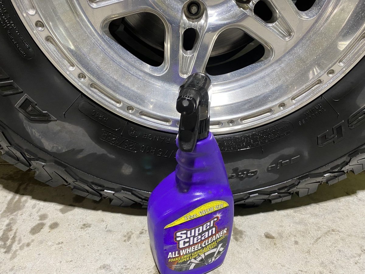

Simple Green is corrosive to aluminum if left on to long.
https://www.ford-trucks.com/forums/1...-old-mess.html
A new item with a good reputation.

I'll second Super Clean degreaser. I learned about it when working on big rigs for cleaning out the cooling systems when an oil cooler goes bad. On really caked and baked grease, I'll spray it down and walk away for an hour, and come back and repeat that a few times until I get it clean. I get it in the 2.5 gallon jug. It is my go-to degreaser for tough jobs.

I'll see if I can find some super cleaner.

Napa should have Super Clean.
