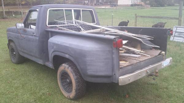

Wasn't a lot of fun but I got them done. date code is June of 1979 and this wheel came out in '76 from what I can find in catalogs. so it's period correct for these pickups.

They were in nice condition so it wasn't as bad as you'd think.
I wire brushed the backsides with a 5/8 grinder. then used an assortment of wire brushes on a drill to clean the coves. followed by 1000 grit sanding of the polished areas and several stages of buffing compound and final high speed polish. then painted the coves with a urethane silver.
I thought about paining the coves body color like everyone used to do but I decided to stay original looking .
Now if I had some BFG's rather than the crappy Interco 16.5 tires I had to buy I'd be thrilled.
