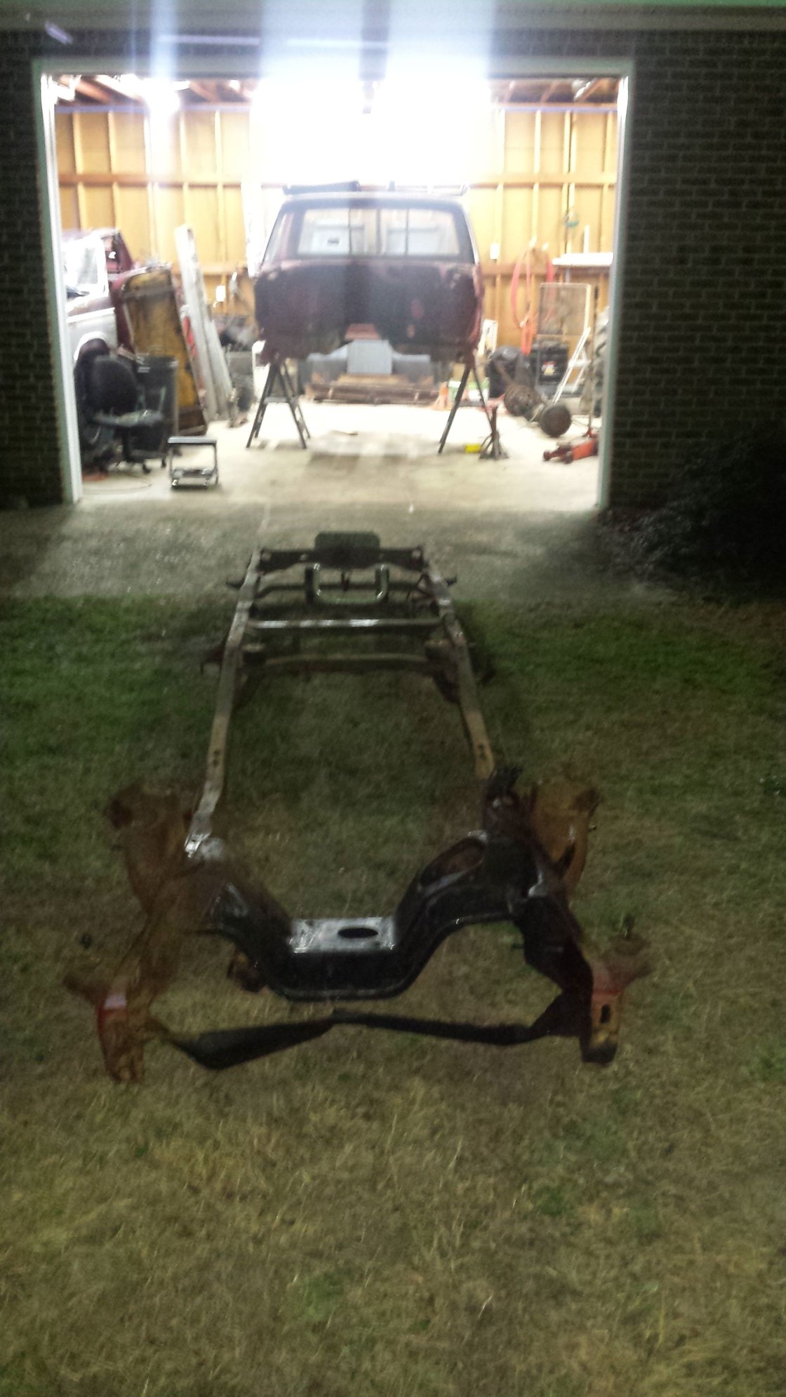

I have to ask how will the cab be supported when you go to remove (gut) the cab?
I had mine a plastic horses and there is no way I could be leaning on the cab or pushing & pulling on things with out it falling off them.
So I gutted the cab before I pulled it off the frame. Here you can see it has been gutted and is sitting on the horses before I pull the frame out from under it.
Bag & tag everything and take pictures. If I pulled say 5 screws out of the dash they went into a baggie and marked "5 screws from dash" and maybe just were they were from on the dash. BTW I was doing this to 2 trucks. The one in the picture I was rebuilding the other was a parts truck.
Also if the cab is gutted it will be lighter to lift. I was able to lift 1 said at a time and push the horse under with my foot then run to the other side and did the same.
