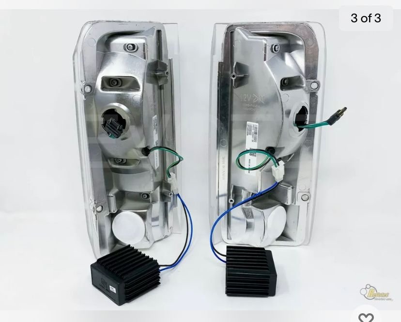

Hello all, project truck is nearing completion. I installed new tail lights (aftermarket LED) and new headlights. All new bulbs in the front and back end. Here is the problem. Headlights and front running lights work but the blinkers won’t blink. Replaced flasher and still no blink. Brake lights and reverse light works when the headlights are OFF. No rear running lights. Once I turn the headlights on I have nothing on the back end.

The tail lights came with built in resistors. Didn’t do anything special for the front except plug in the bulbs

Are the tail lights then NOT bulb-type ones? but a circuit board? I would check who you bought them from, look cheap. Unless they are literally at least enough to be a 1156 or whatever in power draw you should make sure by swapping old lights on the 2 rear to check
OR IF YOU HAVE A TRAILER with incandeescent, hook up, that load may normalise it

Yes they’re the circuit board kind. They were like 125$ for the set (not cheap IMO) Came with a resistor that sits externally from the lights inside the box in the tail light housing.

thats not that expensive either , quality wise. brand?
See, you say it sits in the box. the resistor that would have the resitiing needed, would melt the housing. Unless multiple small ones

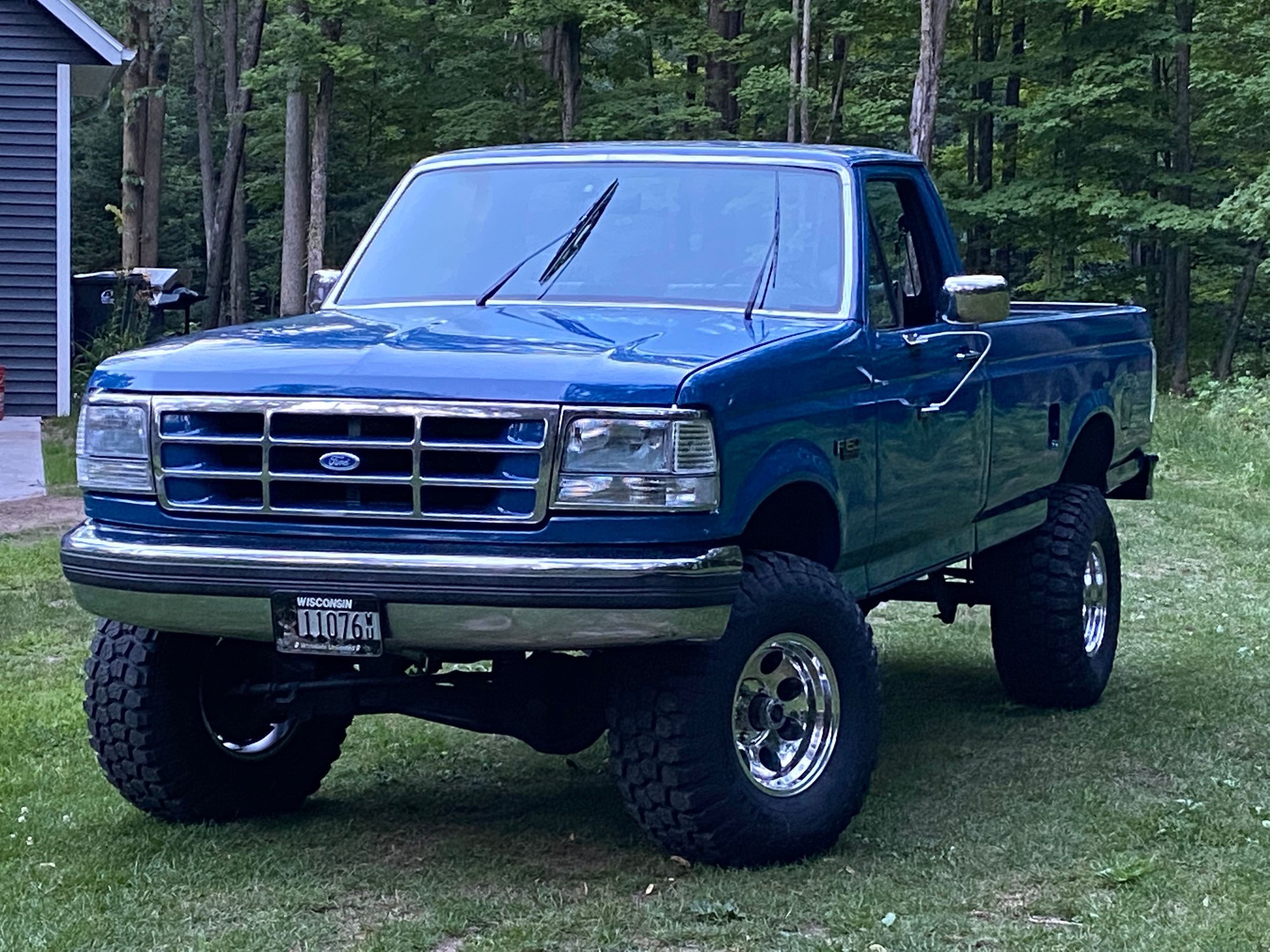

Driver-Side light, headlight and the bezel all look strange
