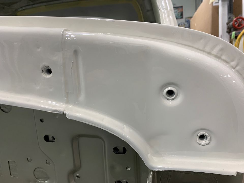

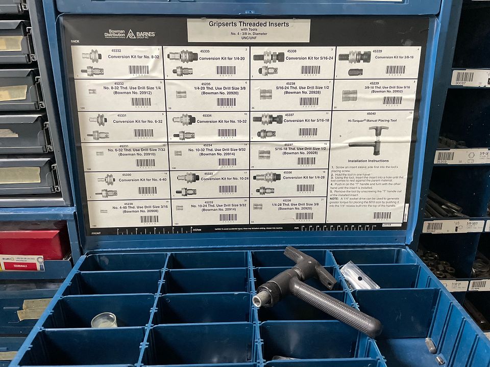

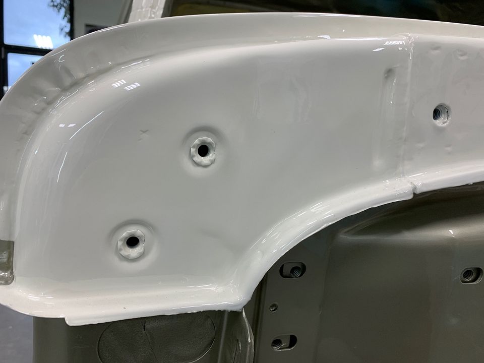

Here's pictures of that area on my truck. Can you tell which one has been replaced? It's the best looking one of the bunch. Second picture middle one. No welding required. There are a few different tools available to set them. They are called "Threaded Inserts" and are not at all specific to our trucks.

Those are crimp nuts that were put in before the body panels were assembled. I don't believe they ever were available. The only way to get to them from the inside is to drill the fresh air box off. Not an option for most folks. If yours are still tight and only the threads are bad, and cannot be rethreaded, I would try a Heli coil. You might want to put a tack weld or two on them to keep them from breaking loose and spinning.

Thanks , I will buy a set like the picture. Once the hinge is on it is unseen. I could have welded a nut from the back but wanted an easier way.Thank you.
