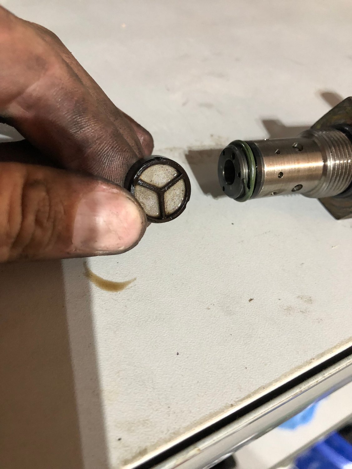

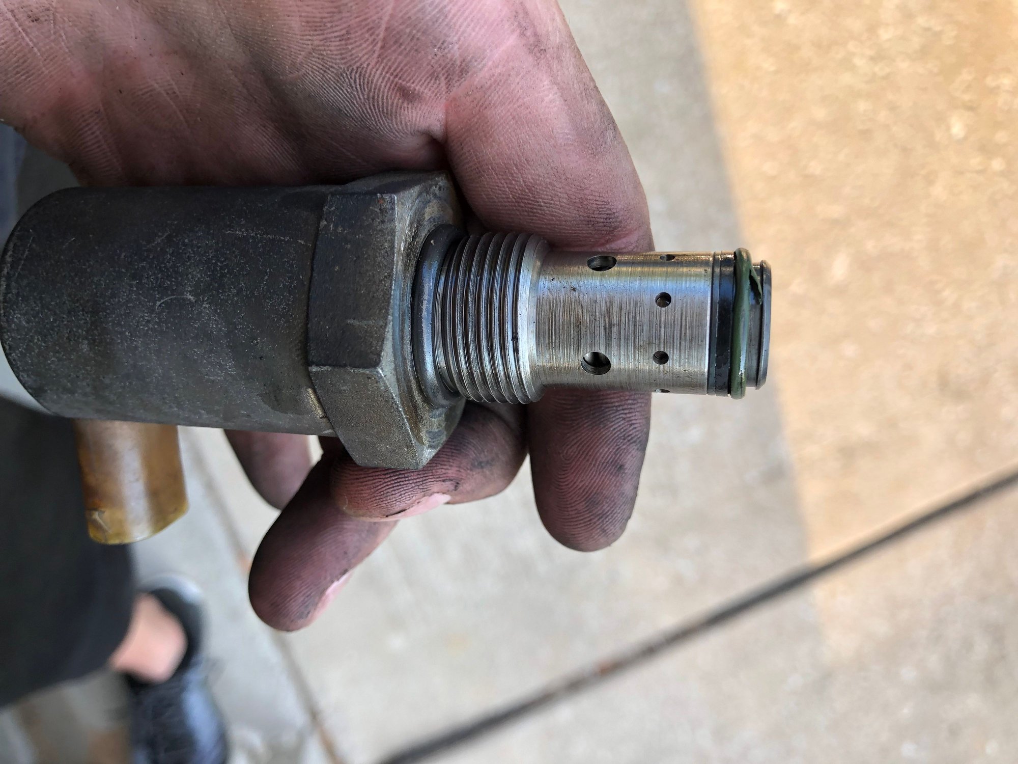

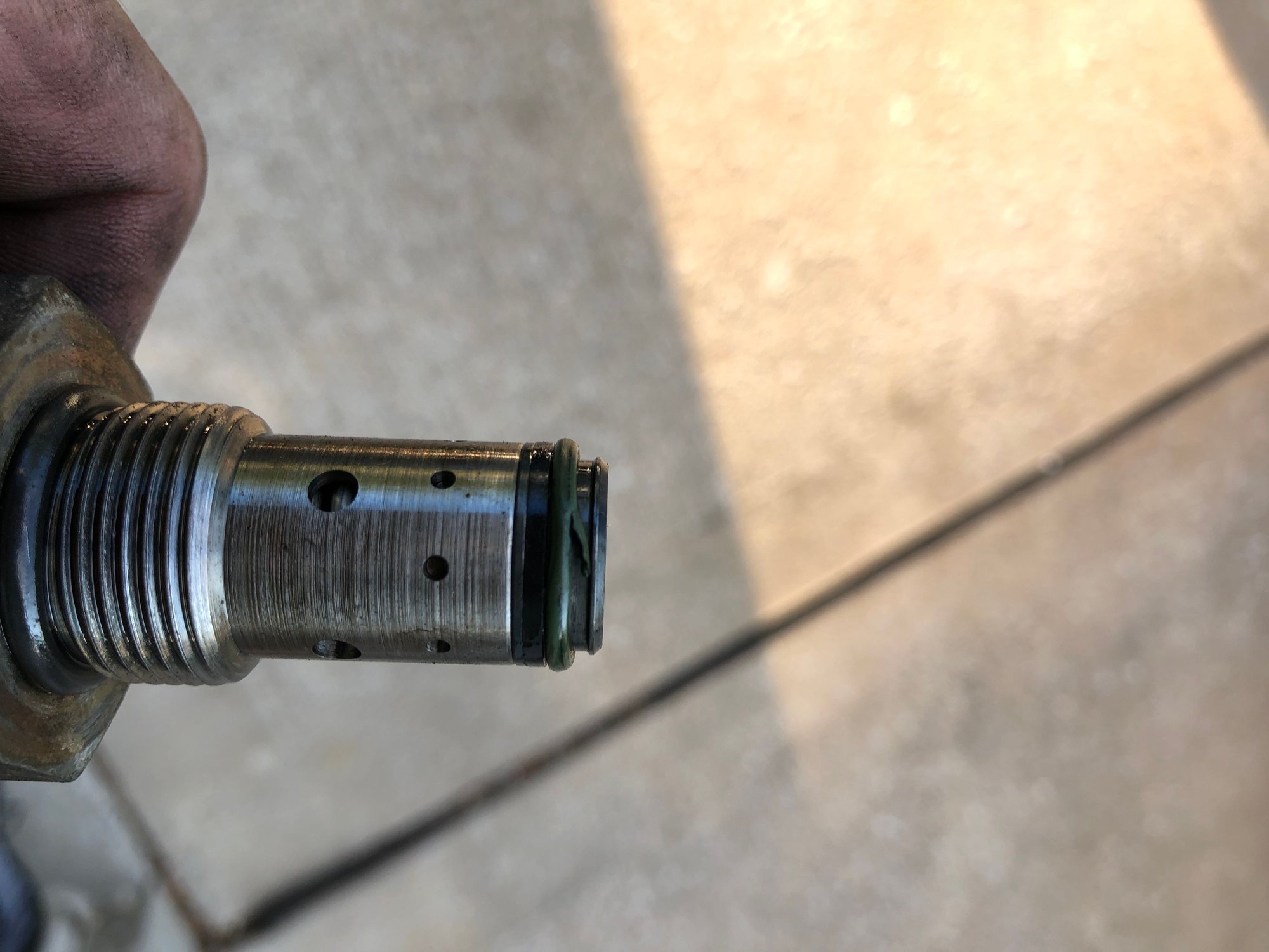

Wires all looked good, pulled the old IPR and found the inner pedestal O-ring had a tear in it also had to fish out the whole cap and screen.

Sometimes a failing actuator (electronics) on the IPR valve gives that code also.

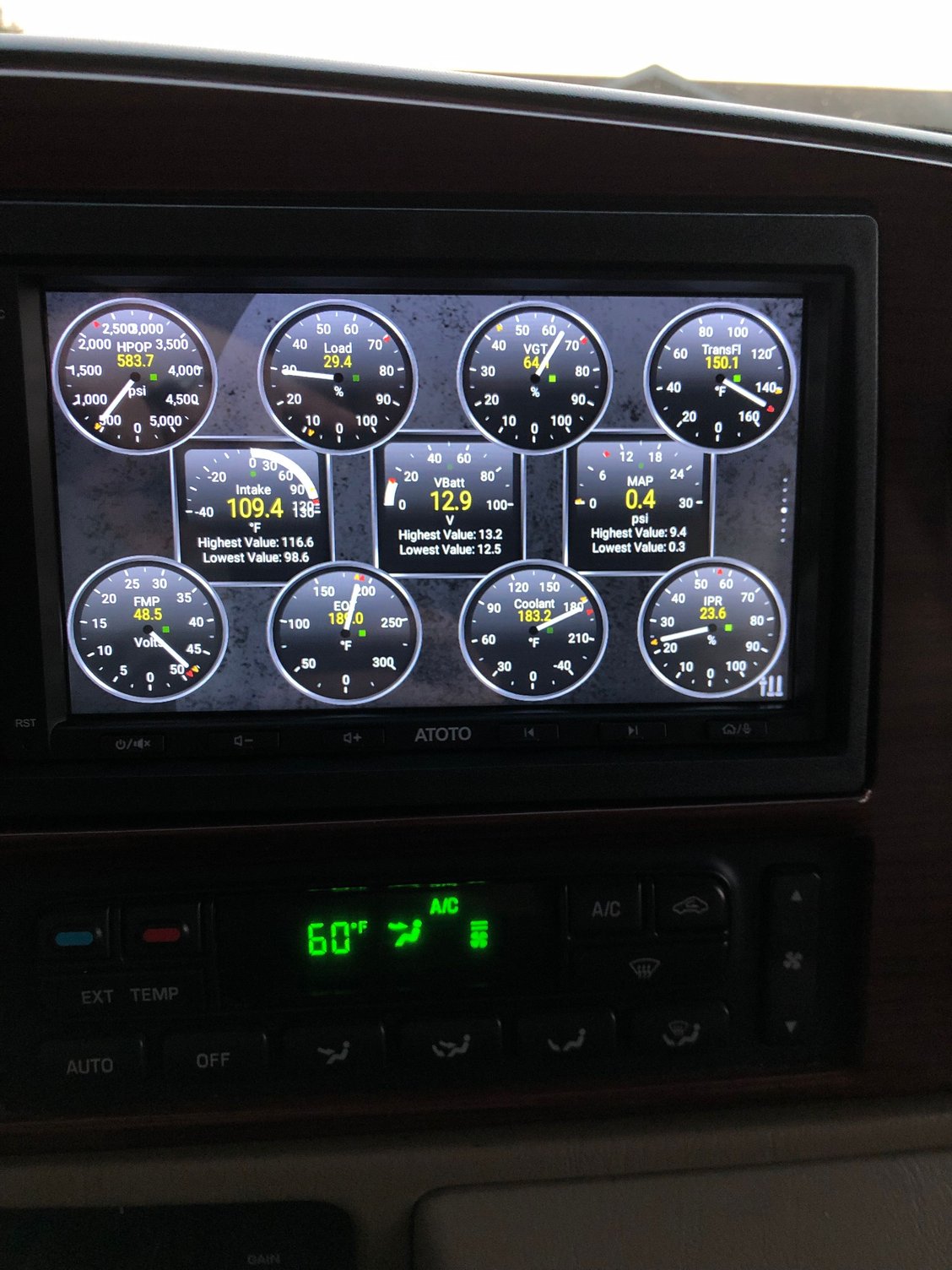

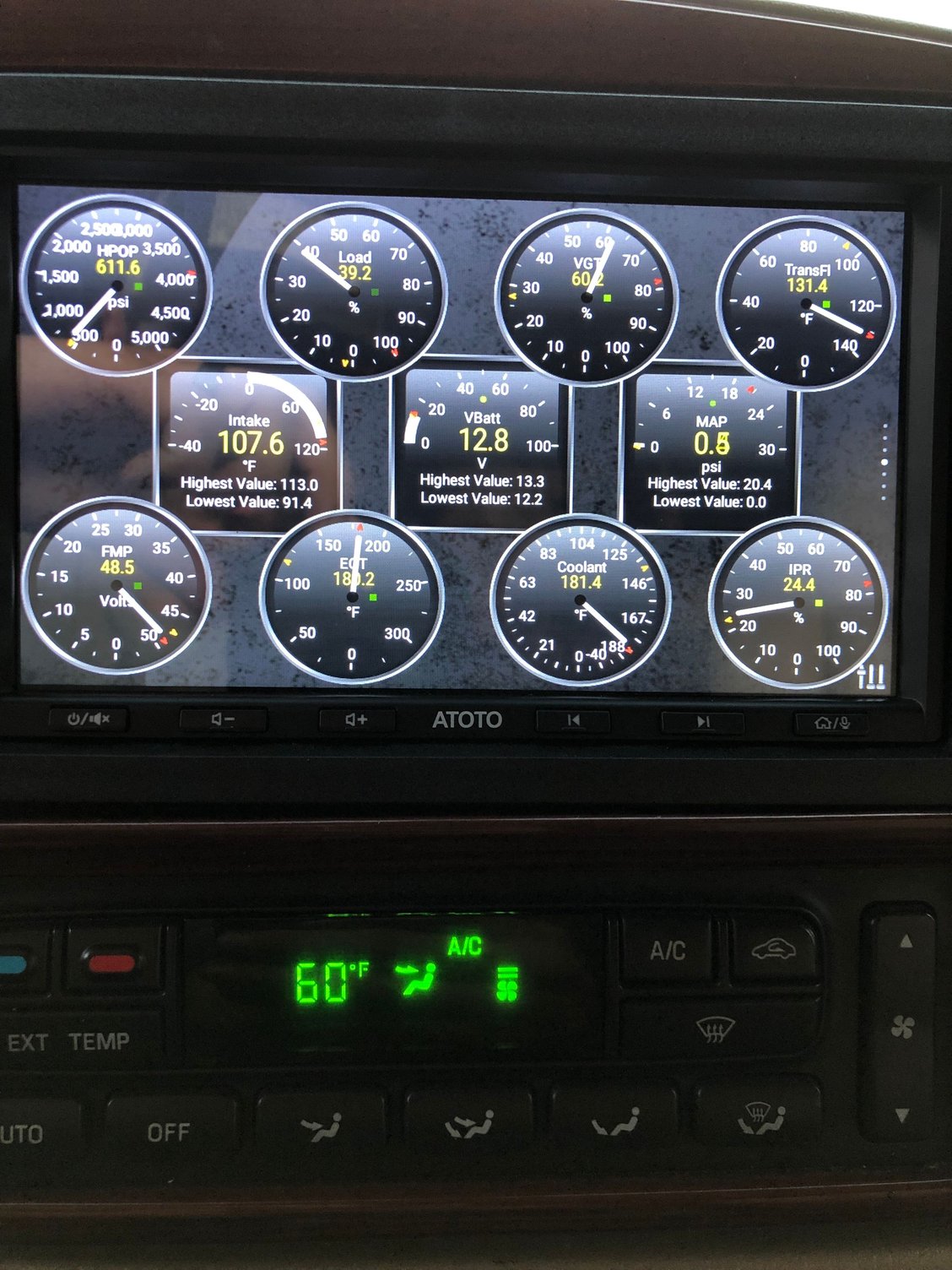

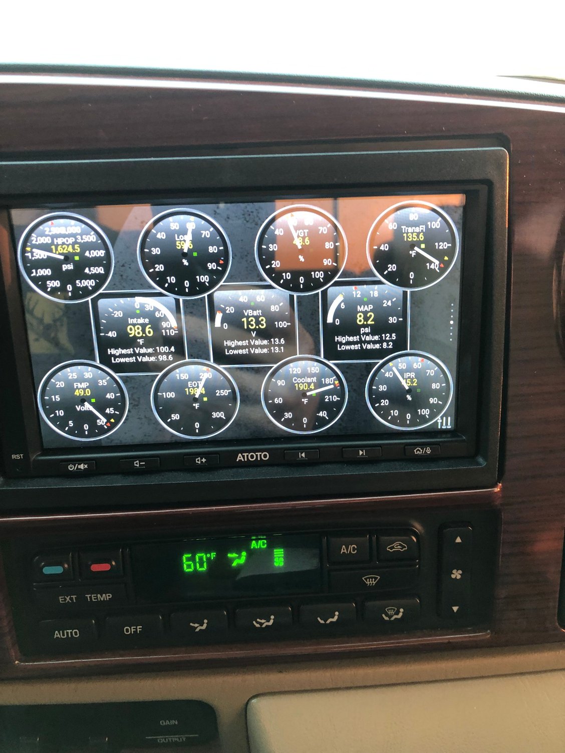

New sensor is in. Took the truck for a drive and it feels more responsive and more turbo whistle.
here are the pressures at idle after a short drive.
here are the pressures at WOT
finally the pressures in the driveway after the WOT

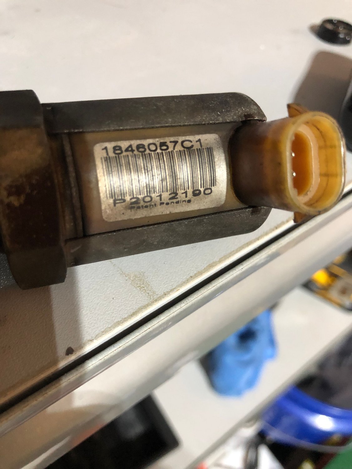

I did notice when I got the old IPR out, the electronic portion it’s self was loose and I could wiggle it side to side, also it says patent pending on it. Fingers crossed that the IPR was faulty and the new motorcraft one is the fix.

Just remember, the electronic actuator is supposed to rotate. That is required so that the harness can easily be re-connected after maintenance.
