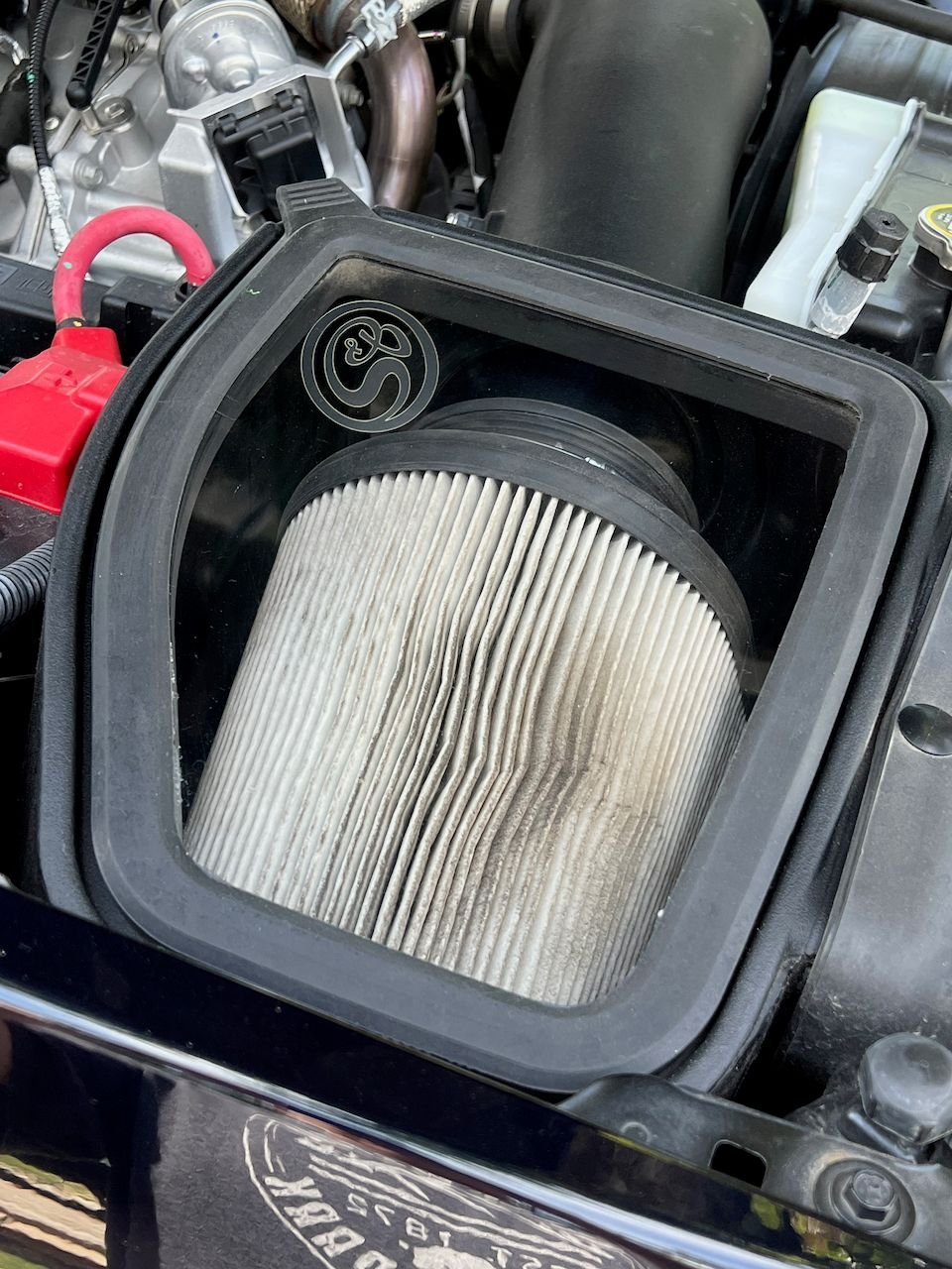

So 6000 miles and just under 3 months ago I replaced my stock CAI with the S&B CAI. I went back and forth on which filter to use, and ended up installing the dry filter. But, I also have a brand new, unused, oiled filter sitting aside (however, it's not with me as I am traveling and will be for at least another month). My question is, when is dirty, dirty enough to change the filter out .(I admit, I never worried about it in other vehicles...) I keep popping the hood every so often and looking at the filter... it's white so any dirt on it makes it look quite dirty. I have removed it a couple of times and knocked the filter against a table to knock any of the big debris in it out, but nothing really comes out. I have been in Iowa, and one thing I realized about the area I am in, is that there are a lot of gravel roads... and a lot of wind... so I would say it's safe to say this is a dusty environment. So I'm wondering, when is the air filter dirty enough to warrant changing it out? Looking from inside the air filter, I still see plenty of light so I think it just looks dirty from the outside. I tried to take a pic too, but it never looks the same in pictures as it does in real life... So, what do y'all think about this filter? (Also, when I change it, I am going to stick with the dry filter and will run a sock on the next one. I don't think I should put a sock over this one at this point...)

Based on what I see after 3 months you should be able to go an easy annual filter change. That's what I do on a stock Motorcraft filter, and I don't even inspect it because I don't want to jeopardize the sealing surface and allow some contaminants to bypass the filter.
When the filter's shape becomes distorted that's a tall tell sign you probably went too far.

I would change annually or when the filter is completely black.

My diesel spends alot of time in off road conditions taking my 5th wheel into boondock locations on forest roads/ blm roads or desert roads and even in the dusty conditions after 5 1/2 years and 55k miles I've only changed it 3 times and even then it didn't look that bad. You would be surpised how dirty a filter can actually get and still be effective.
Don't loose sleep over it. That filter pic looks pretty clean in my book. I would worry more about all the bugs and debris that get packed in between the front radiators, a yard stick works well cleaning the debris out.

Thanks guys for the responses! I'll give it some more time before I change it! So, would throwing a sock on it at this point kind of be pointless? Like I said, I want to add one, but I was thinking I would just wait til I put a new filter on. Sure seems like it would help prolong the filters life, however, I wonder how much it would reduce air flow...
