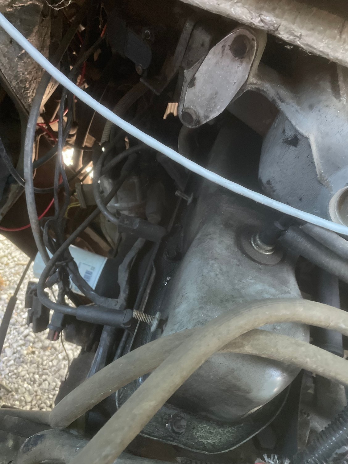

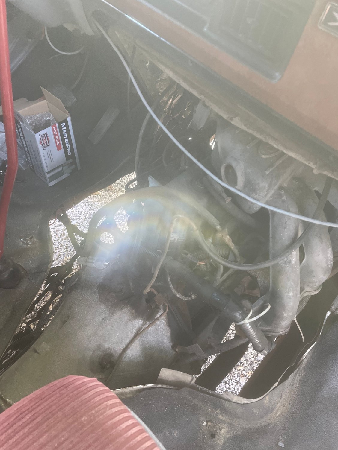

Hi Guys! First post and look forward to learning from you guys!
I purchased what the title says is a 1980 Ford Econoline XLT. It ran when we bought it but badly. Long story short is we narrowed it down to a ECM. I sent it off to SIA electronics and they let me know that it was not repairable. 1 of the main problems is this was an MY80 with a MY87 4.9L the ECM has no identifying stickers and the door well sticker is blank. Is there any other suggestions on how I can go about getting or finding a replacement. Also unsure of which automatic transmission I have. Please help guys!
