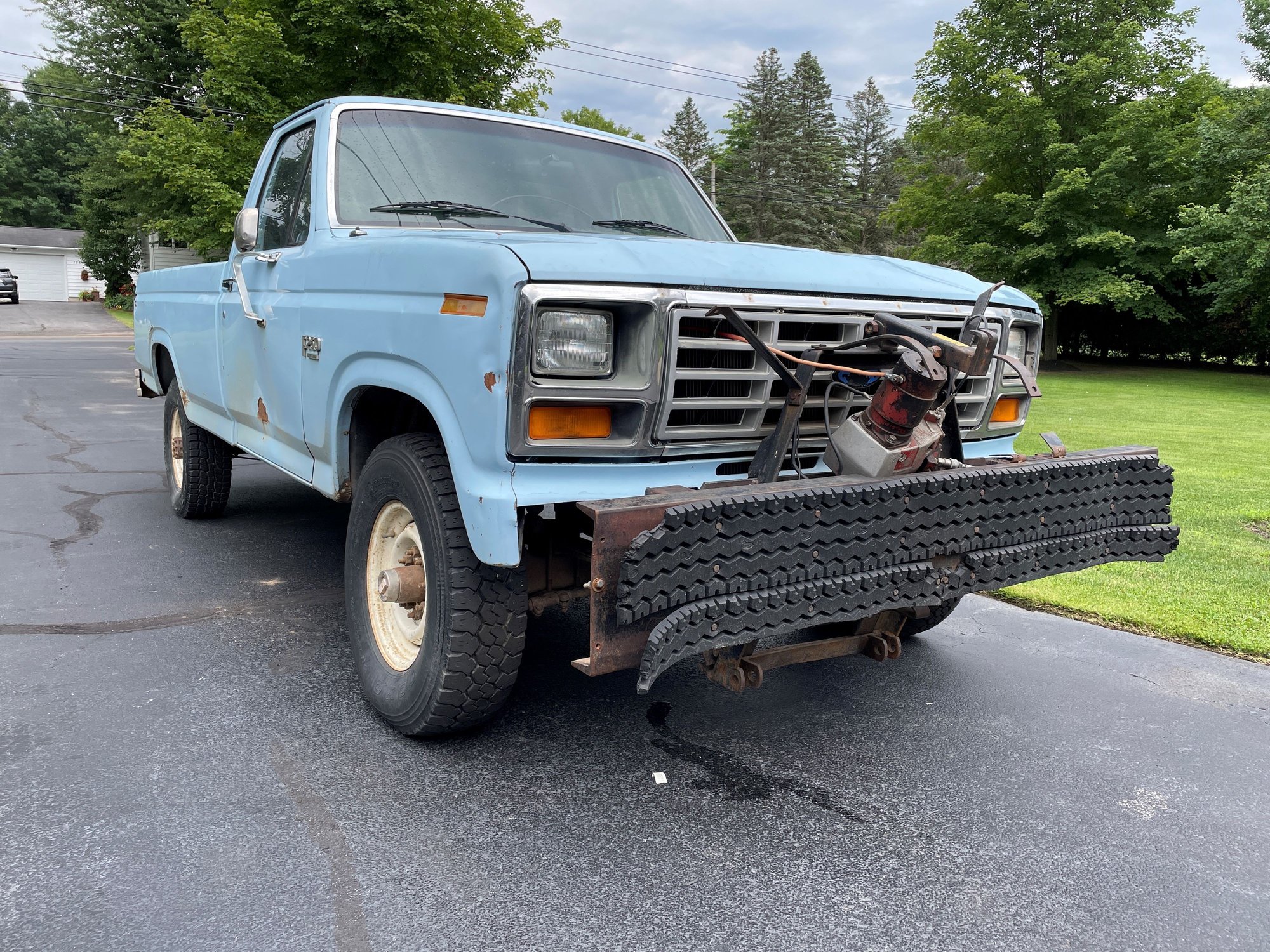

Hello all, I'm new here. I just acquired a 1985 F250 4x4 with (of course) a 6.9 IDI and Dana 44 HD TTB front axle. The camber is way negative on the passenger side front wheel and it's driving me crazy. The truck drives down the road really well, absolutely no ride or steering issues whatsoever. The ball joints look and feel tight. The theory is that years of carrying a plow and a 6.9 around have ruined the front springs which has caused such a negative camber.
I'd like to add a small add-a-leaf to pick the front end up just a bit and maybe correct some or most of the negative camber, then I could always go in and add a degree or two with an adjustable camber bushing if needed. I'd assume just the add-a-leaf will get me most of the way there, though.
My question is, can anyone recommend a good add-a-leaf and/or tell me how your experience went with them? I'm presently looking at these two options:

negative camber driving down the road, or when backed into the driveway?
these trucks with TTB will be all jacked up when backed into someplace, but once you move forward around 10 foot or so the front end ligns back up and tracks straight. it is the nature of the TTB beast.
if the front tires are no wearing funny, i would leave it be.
In that photo, I had just pulled into my driveway after driving for a mile or so. Interesting info though. The front passenger tire is wearing funny on the inside edge. This photo doesn't really do the camber justice, it's quite marked when viewing the truck straight on.

Did you measure the ride height & camber to be sure you do in fact have bent springs? Like Tom said the camber looks funny on these trucks sometimes but the tires still wear OK.

Ride height is almost identical on driver and passenger sides front and back. Front - garage floor to bottom of wheel well edge is 35" and rear it's 37, both sides give or take a small fraction of an inch here or there. I have not measured the negative camber as I have't had the truck aligned yet but it's quite severe on the passenger front wheel, not so severe but still present on the driver front. The passenger front tire is wearing oddly on the inside edge in what is quite clearly a result of the severe negative camber. It needs to be addressed. At this point I'd almost prefer some positive camber without the load of the plow which would afford me somewhat of a normal angle when the plow weight is on the springs.
That said, I don't suspect the springs are "bent" per se, just worn out. They have a significant negative arch but I'm told that's pretty normal across the board for these trucks. The plow frame is very close to the ground in the front, and that's without the weight of the plow. Once I get the weight of the plow loaded on the springs, I bet that plow frame is damn near scraping.

I don't have access to the factory ride height specs, but that is well within the typical front-rear variation of light 4x4 trucks. You're allowed up to 5/8" side-to-side difference in wheel arch height for the 80/97 F-250 and F-350 w/ front leaf springs, so if you can't measure any variation at all it's unlikely there is anything wrong with the springs. If you're seeing a notable variation in tire wear and camber angle, most likely you have a bent or worn suspension component closer to the wheel end than the spring is.
Things I'd look into, in this order:
Wheel bearing play- are the retainer nuts tight?
Kingpin wear if your truck is equipped with them
Caster/camber cam on the right side, if your truck has one, is indexed correctly- not unheard of for someone to remove it to replace a ball joint, forget to mark it first, then install it wrong
Possibility the PO threw on a pre-worn tire before you bought this
Use a tape measure to take rough measurements, then see if you can get them closer to 1 or 2 degrees positive by moving the cam. Eventually an alignment shop should dial everything in with a Hunter machine, but until you find the problem a tape measure is perfectly adequate for your purposes.
I see what you're talking about BTW, just took a second look at Post No. 1 and the minus camber on the RH front wheel is hella off. If it's so bad you can tell just from a picture, something is seriously wrong and you're right to be concerned.
