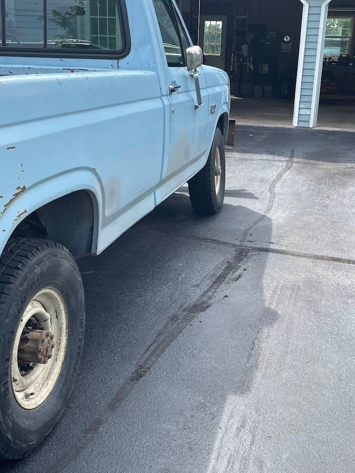

I don't have access to the factory ride height specs, but that is well within the typical front-rear variation of light 4x4 trucks. You're allowed up to 5/8" side-to-side difference in wheel arch height for the 80/97 F-250 and F-350 w/ front leaf springs, so if you can't measure any variation at all it's unlikely there is anything wrong with the springs. If you're seeing a notable variation in tire wear and camber angle, most likely you have a bent or worn suspension component closer to the wheel end than the spring is.
Things I'd look into, in this order:
Wheel bearing play- are the retainer nuts tight?
Kingpin wear if your truck is equipped with them
Caster/camber cam on the right side, if your truck has one, is indexed correctly- not unheard of for someone to remove it to replace a ball joint, forget to mark it first, then install it wrong
Possibility the PO threw on a pre-worn tire before you bought this
Use a tape measure to take rough measurements, then see if you can get them closer to 1 or 2 degrees positive by moving the cam. Eventually an alignment shop should dial everything in with a Hunter machine, but until you find the problem a tape measure is perfectly adequate for your purposes.
I see what you're talking about BTW, just took a second look at Post No. 1 and the minus camber on the RH front wheel is hella off. If it's so bad you can tell just from a picture, something is seriously wrong and you're right to be concerned.
Thank you, very good info here.
Yeah that negative camber is so bad on the right front that you don't even need a tape measure, you can just eyeball it. I was prepared to go playing with camber adjustment bushings but then someone (can't remember if it was here on one of the facebook groups) said that normal spring wear and subsequent loss of ride height can cause a ton of negative camber. You're right though, it is odd that it is far worse on the passenger side and almost non-existent on the driver side yet the ride heights are almost identical. I will have to pull it apart and check the bearings and retainer nuts. It's got ball joints and according to my layman's "testing" they seem tight and normal.
I found a good deal on some HD replacement front springs but the problem is, I don't want to jack up my front ride height so high that I get other alignment issues. Right now the truck drives perfect down the road, no wander, no pull and perfectly smooth and that's with this huge amount of negative camber on just one side. If I just fix the camber with a bushing, I'm still putting the weight of a 6.9 and a plow on old old leaf springs that look a little saggy.
Not sure what to do.
If you expect to have the plow on for a significant portion of the time, then a new set of aftermarket springs isn't the worst idea in the world. But if it was my truck I would want to know precisely why the camber issue exists, before making a decision about how best to address it. There's gotta be something seriously f***ed in there somewhere. Another thought that just occurred to me, what about the rubber bushing where the I-beam attaches to the engine cradle? Might be worth a good look.

Well, the ball joints upper and lower and outer tie rod ends were toast on both sides.
On the driver's side, the lower ball joint nut was only on hand tight (keep in mind this is the opposite side of the tire with the camber issue). Axle joints are toast, wheel bearings looked OK but I'm changing them anyway. Also the pivot bushing closest to the passenger side is toast, I'll be replacing that with poly.
As usual with old trucks, the removal of one part led to a cascade of discovering more worn parts. Trying to decide where to stop with this thing.
At this point, I'll replace all the worn front end parts and hold off on the add-a-leafs I think. After all this work, I'd rather not start taking springs off. Hopefully the upper shackle bushings are OK. God I am so sick of doing front axles.

This is with the truck supported in the air and the front axle at full droop. This is the passenger side axle beam and leaf spring as viewed from the rear looking forward. I am grabbing the passenger front tire at the 12 and 6 o'clock positions and rocking up and down. The whole thing moves, springs, shocks, knuckle - there's movement everywhere.

This is the driver's side which looked completely fine camber wise. Looks like the PO replaced the axle shaft with a junkyard part very recently and just slapped it all back together haphazardly.

Your front end is totally wore out.
If it was mine, the thing would be ripped out, sand blasted painted and all parts replaced
and front end alignment.
Looks to me as loose as the parts shown, an accident waiting to happen.
Comes a point we can`t nickle and dime things to keep them going.
Becomes a safety issue.
My 86 2wd, had worn Pivot Bushings, thought it was all that was bad, then found the
king Pins were loose etc... so replaced everything including new Coil Springs.
She`s like brand new again.
