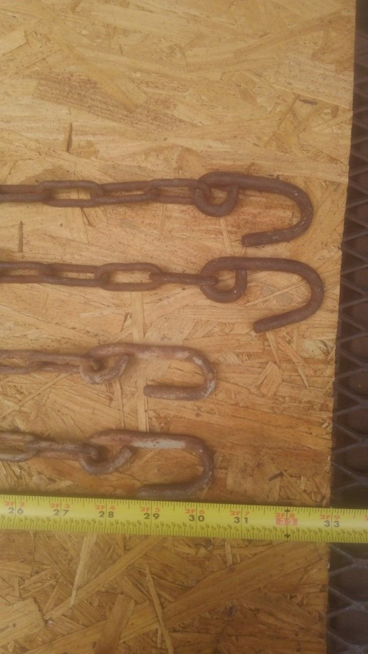

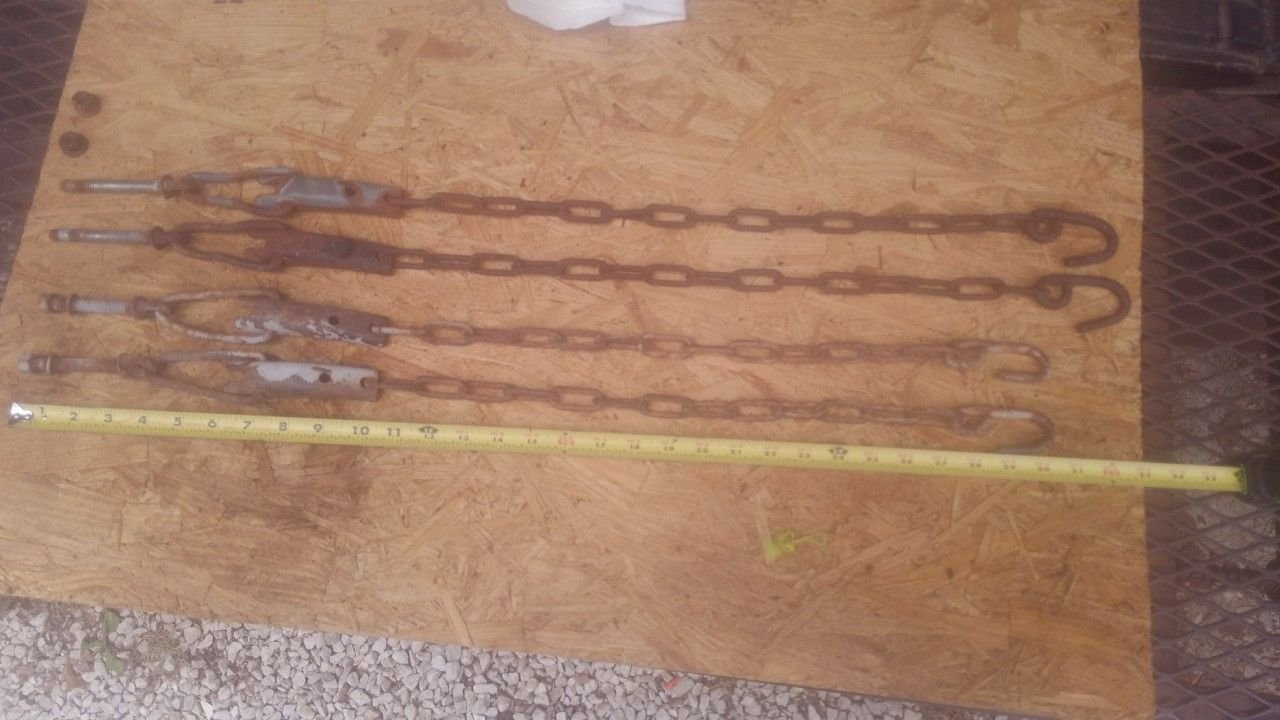

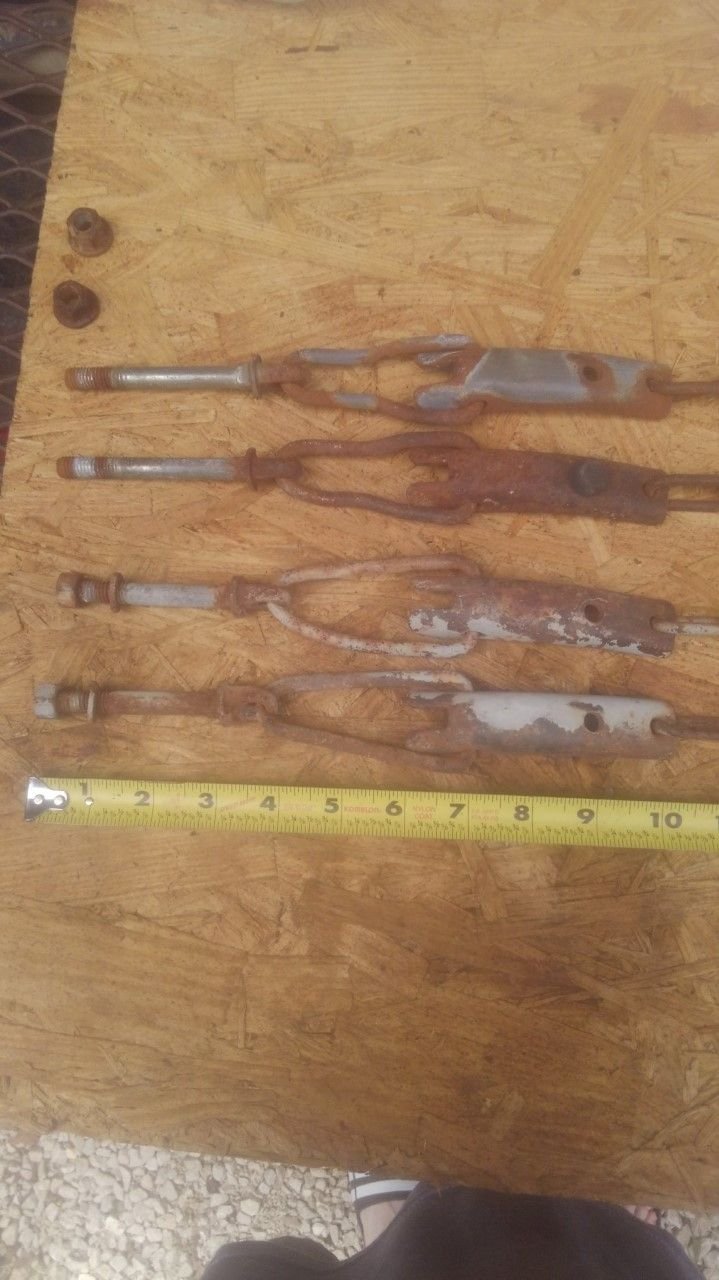

I would go measure yours and then call the parts vendor tech line and ask that theirs measure out to be. Let me go hit my parts shed with a tape measure, I have 2 spare sets. Not 100 % but very reusable.

Yeah, seems like measuring is what I'll need to do. Or wait for the one place that had a D7TZ part number to get back to me
