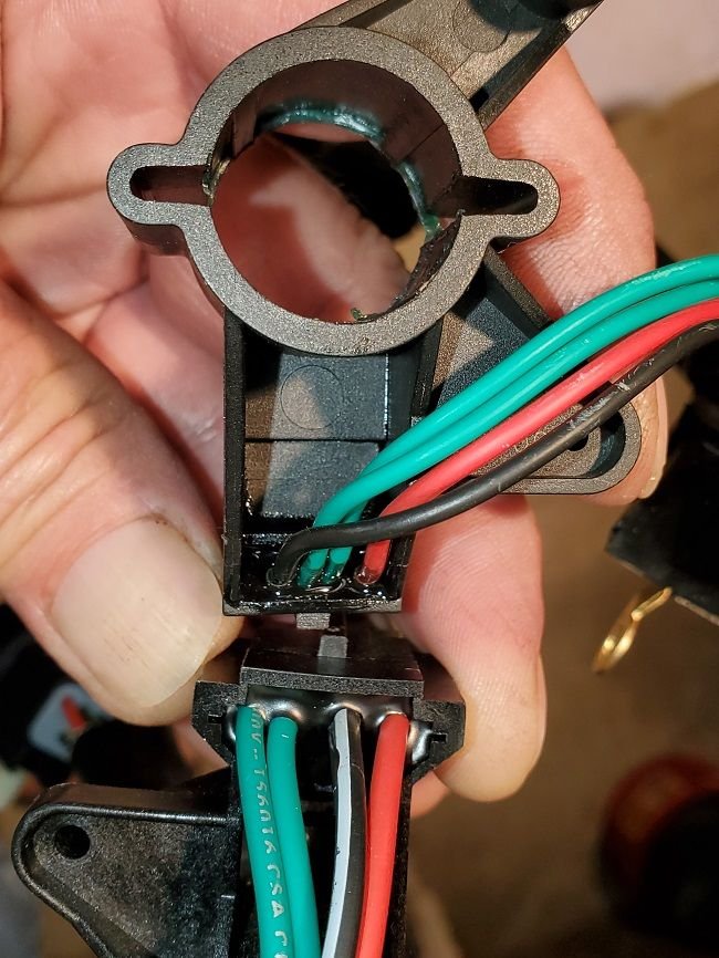

Yeah, I bought one of the box store China made replacements & essentially used the body.
Went back with a new Motorcraft PIP & the original stock shaft, gear & shutter wheel.
Went so far as to re-used the stock roll pins after a friend sheared 2 roll pins in his China replacement.

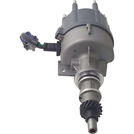

random photo for reference. do you see the small circular thing on the gear? thats a roll pin, just needs to be pushed or lightly tapped all the way out, then the gear should come off the shaft

The difference in a aftermarket PIP & a Motorcraft PIP:
