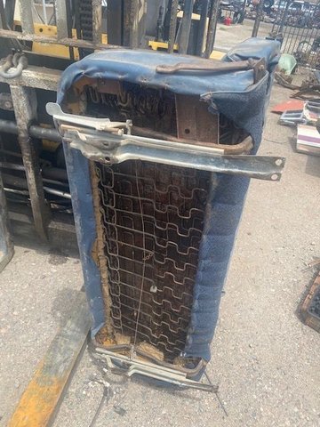

Thanks SuperSabre - all good advice. There’s definitely a domino effect. My plan is to get the bench seat in, which I know I want to do, and see what kind of space I’m working with. No power steering, unfortunately.
But was able to pick up this 66 bench from DVAP. Off to the upholstery shop…

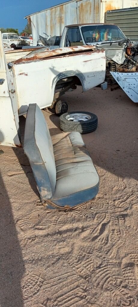

You live in Connecticut and had the bench seat shipped from Arizona? That's a good distance. Might be more miles than that bench seat had made in a while. That's one huge junk yard in the desert. Click the link for a satellite view.....
Google Maps
