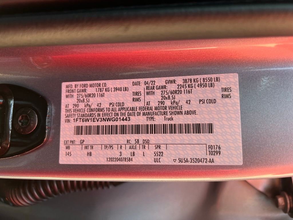

These are photos from my dealer's demo truck. It's a Lariat extended-range trim.

Must be a really heavy truck as the GVWR is 1500# over our loaded short Platinum. But it has a payload 100# less. Seems strange.

Yeah EV's are heavy due to the battery pack.

From what I gather, the battery for the extended-range Lightning is about 1,800 lbs. That’s a heckuva lot heavier than a gasoline engine, transmission, and fuel tank. Then add in the weight of the electric motors and rear suspension, which I’d guess is heavier than a comparable solid axle. Quick door sticker math on that demo shows that the truck weighs just under 7,000 lbs.
