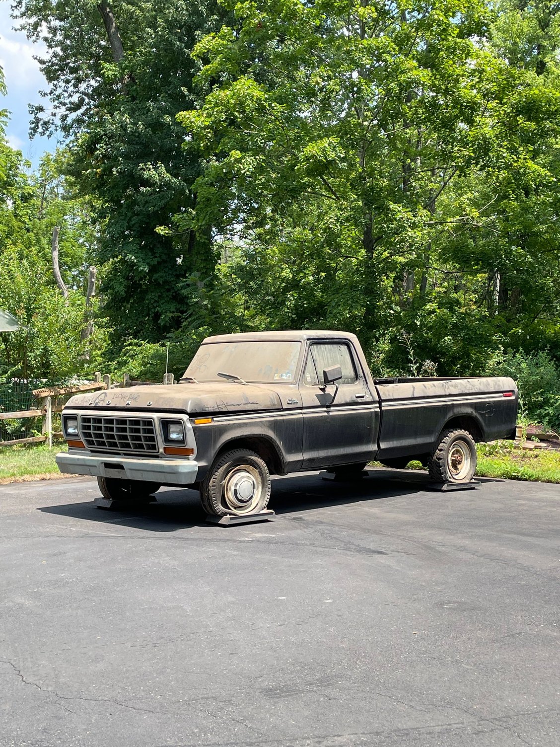

Had this True Barn find towed home this afternoon! She's an F250 Black/Red 300 six banger. This pickup has been stored in a Barn just down the street from my home since 1996! Rust free!!!!

Looks like a nice solid start. Hard to tell from just one picture, but all I see that it needs is a bath.

Barn stored for a long time ='s mice and mice droppings and wiz, and that stuff is just as bad and causes caustic rust. In the floor pans and other areas. They build mouse hotels with all bit of chewed wiring insulation like in the roof seam between the A and B pillar. You will find it when you drop the head liner. Turn on the vent system blower and rat mini biscuits and wiz stink can come at ya.
Fuel tank might as well be dropped and replaced. And that normally means the sending unit too. Take it easy when you work to get it back to DD status and all sorts of seals can start pukeing on you. T stat sticks, tranny pan leaks.
But ha it is a barn find so enjoy.

She's a solid piece for sure! No rust or dents, nice and straight! Great color combo to boot!

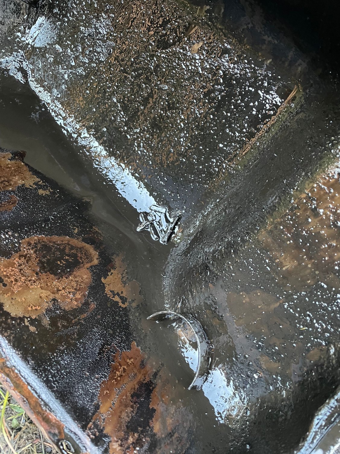

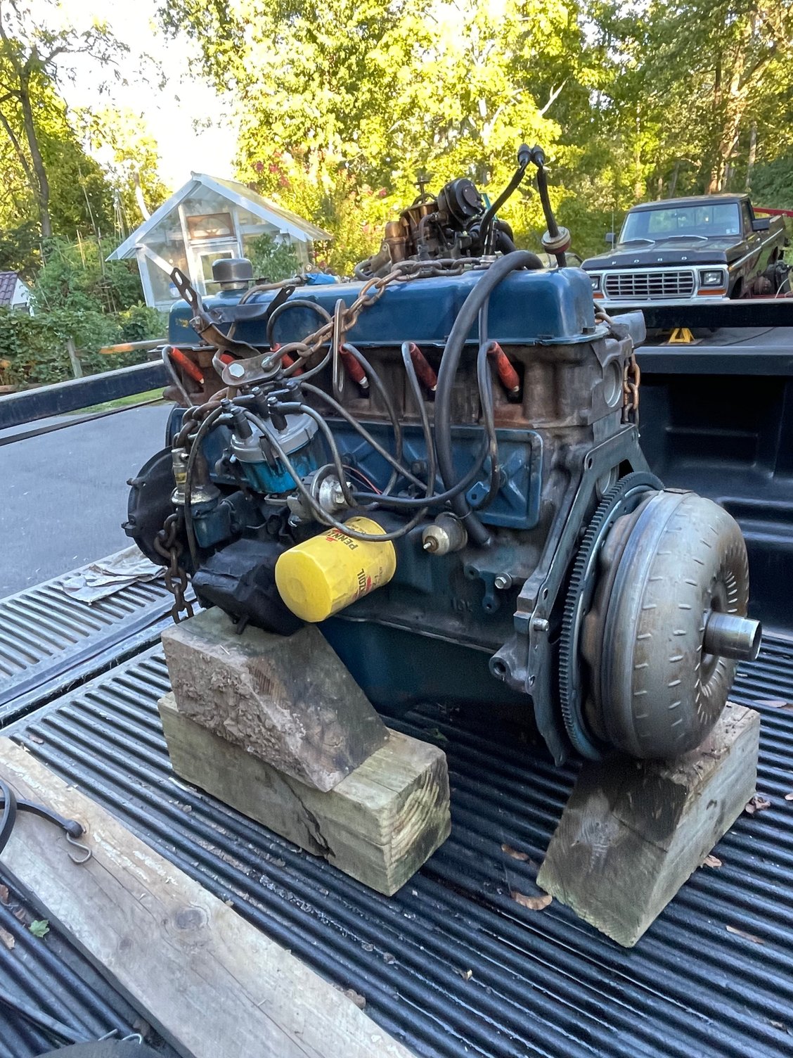

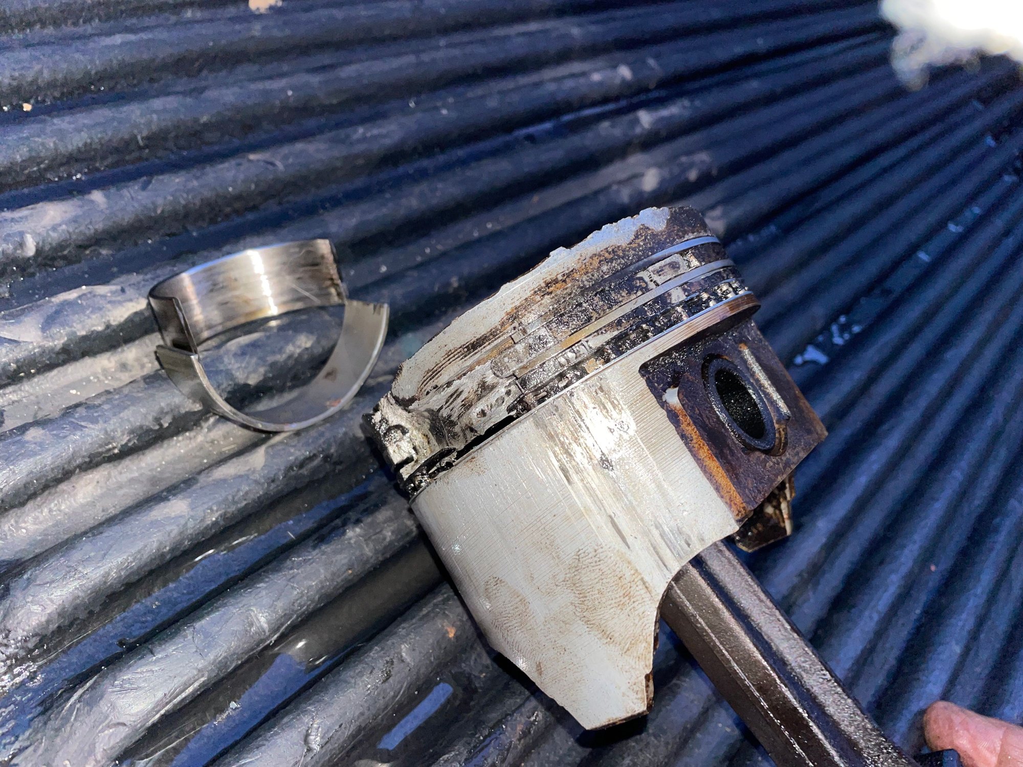

Not good......Please explain how an entire bearing can come out......Engine is toast, IMO......

Likes: 594
Oil contamination, and or overheated. The block is probably good for machining, but I imagine the crankshaft is wrecked. Good opportunity to swap to a Windsor engine.

From: Near Los Angeles
That's too bad. If the block is toast, you can grab a block from anything all the way to '96, which is the last year for the 300. The block will be identical. If it were me, I'd double the horse power of that 300 by adding an Offenhauser C intake and a 4v carb, an msd ignition box and the efi era split exhaust manifolds or a header. That will take you to about 250 hp, and, if you install larger valves and do some bowl work in the head, you'll be moving in the direction of 300 hp. With a nice over-drive transmission, you'll be making 20mpg on the highway, if you keep your foot out of it.
That is what I did with my 360, and I never regretted it. Everyone in the world has a souped up v8. How many people have a hot inline six? Check out this forum: https://fordsix.com/forums/240-300-b...performance.2/
Good luck.
