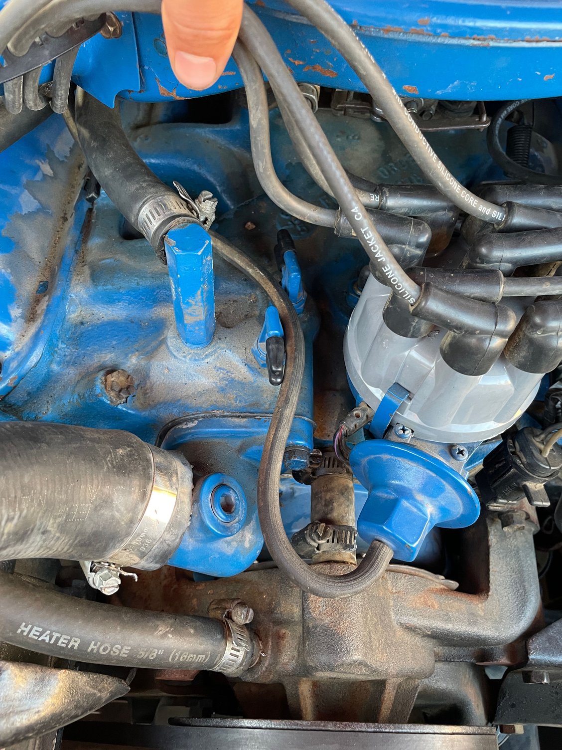

I’ve been building a 1976 F-250 Ranger 360 5.9L 2 barrel Motorcraft 2150. I rebuilt the whole engine, went through the brakes, steering, and axels. Now I’m to the point of just working out kinks. One of them is that the engine will just stop firing once it gets hot. I replaced the ignition coil and wiring for the ignition coil. I also tested my ignition module and that’s all good. I suspect it may be something to do with vacuum. I have almost all the vacuum ports plugged. Is there anything I should unplug?
I suspect the culprit may be the vacuum ports the distributor advance is between.

Vacuum hoses or leaks will not cause an engine to stop firing.
How did you test the ignitiltion module and the coil when hot?
There is a pickup inside the distributor too you know.
