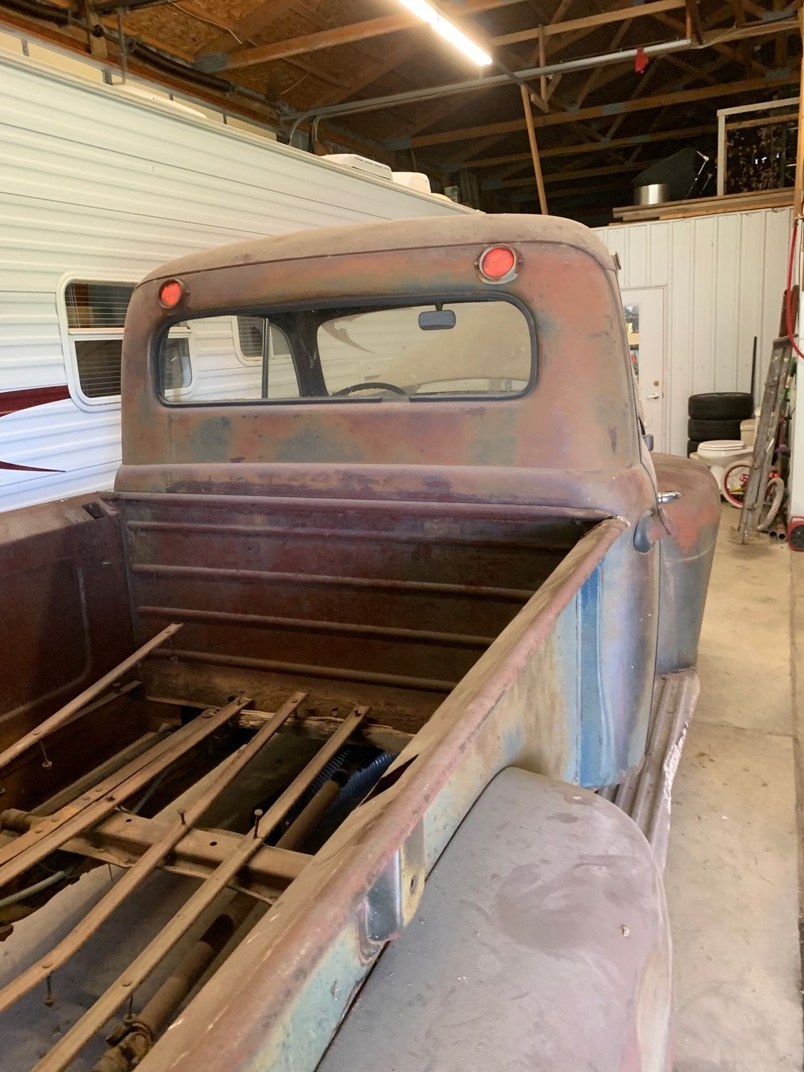

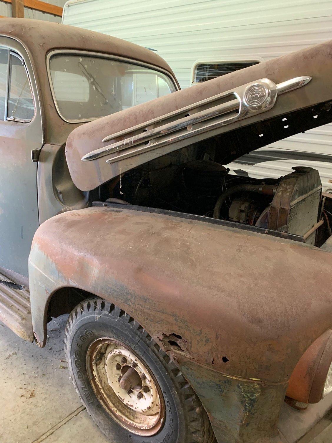

These are pics from a little over a year ago as I was buying the truck. I have had it on the road once last fall, but couldn't work on it again until this week. I plan on leaving the patina (after cleaning up what's left of the paint). I have replaced brakes / lines and master cylinder, fuel pump and lines, front shocks, I have a new interior to install, have new bed runner strips and hardware to install cherry wood bed boards (making them myself), new wheels and tires, and recovered the seat.
Fun project so far, love this era vehicles.
By the way, my friends 80 year old dad suggested on the day I brought the truck to his farm, to drain oil, fill entire engine with diesel fuel and let sit overnight before trying to start. I sealed off the oil dipstick hole and did that. About 24 hours later, I drained the diesel fuel, pulled the old plugs and let everything air out. Added oil to the crankcase and cranked the engine without plugs for about a minute. Replaced that oil one more time, put in new plugs and after 15 years of sitting, we had the engine running shortly after off of a gas can. For what it's worth. And probably 200 mechanics that will say to never do that, lol. I'm not a mechanic so took the advice and seemed to work.

Welcome. Nice looking truck, great patina.
I sent my carb to Charlie NY after attempting to rebuild it myself 3 times. He’s on the fordbarn forum. When it came back he’d missed a vacuum leak, but he stood behind his work. While it was on the way back to him I bought a repro from Chuck’s trucks. Now I have an extra carb and the truck is running very good.

On the patina, I'm thinking of doing a wet sand to get as much Sheridan Blue to come out and then probably do an oil coat; at least that's what I'm thinking at the moment.
Wes
Sounds like a great plan. I would’ve done that to mine if it had all been one color, and anywhere near original. My truck had at least 3 different colors under the current color. I suspect different companies owned it over the years and painted it the company colors, the last being “Tires 40” which is stenciled on the glove box.
