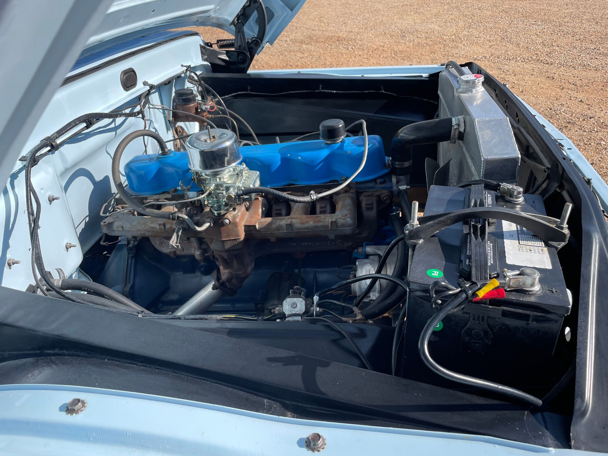

What I'm seeing in that picture may be the wrong carburetor for a load-o-matic distributor if that is what you have. A Holley 1908 would have a spark control valve, but I don't see one on that carb. The shop manual lists three different carbs for a 65, 240. Two are for load-o-matic distributors and one for dual advance distributors. None are Holley's. But if you have a dual advance distributor that Holley might work if it doesn't have a spark control valve in it.
Unless your engine has a dual advance distributor, it should have one of these. Tomco Ford 1BBL Carburetor 192 | O'Reilly Auto Parts (oreillyauto.com)
Whatever you have you need to lose that lawn mower air filter at your altitude you need something big enough to let some air in.
