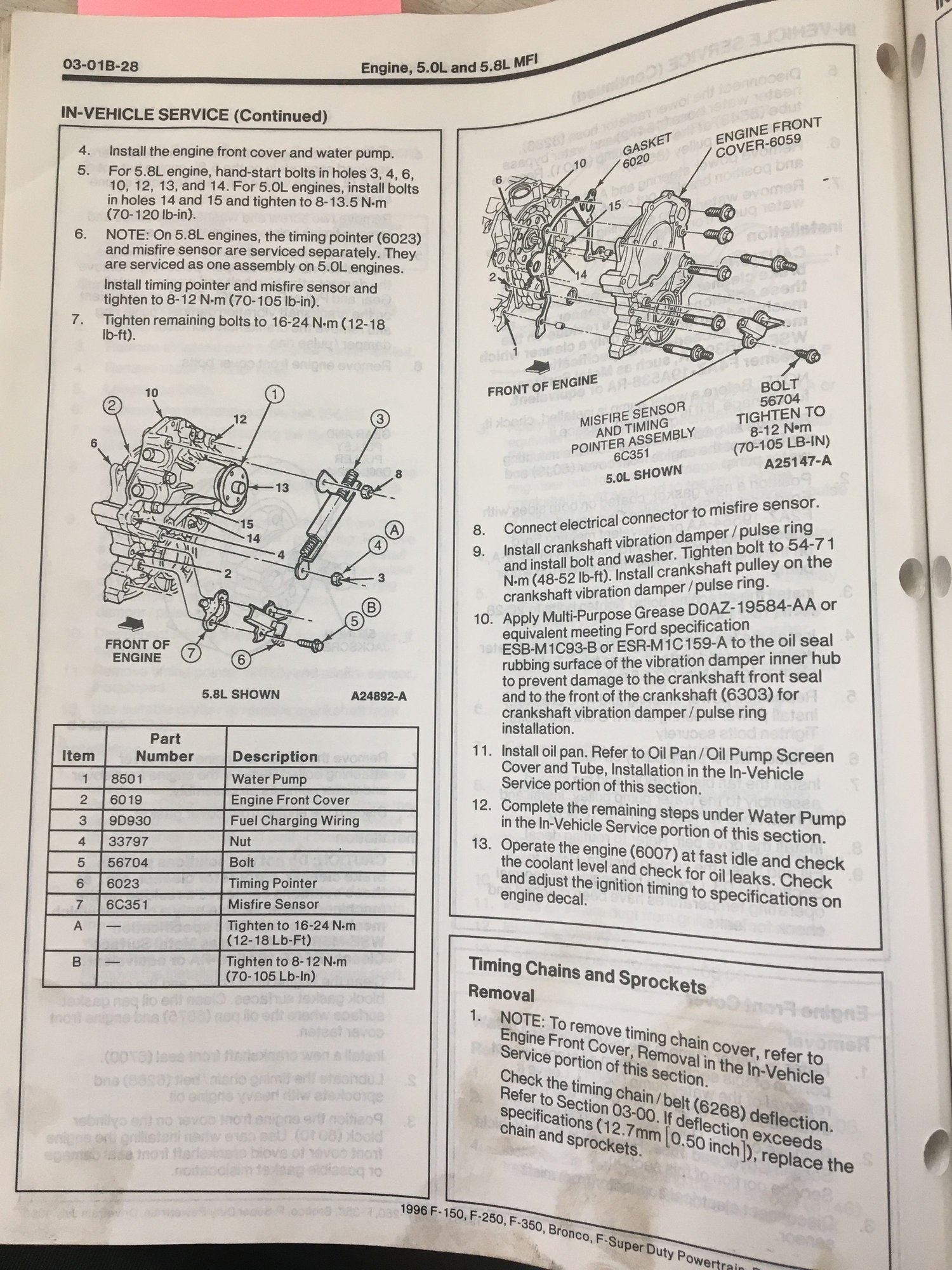

OEM part numbers, such as the water pump above mentioned are in the FSM. You may be getting confused by Engineering numbers, which most use interchangeably with PN's. Most websites I find use EN's and their own aftermarket PN, not OEM PN's. Faulken is correct on that.
Example: Water Pump (This is from a 1996 FSM - Do not use this part number or page for yours, it may not be correct - it is just an example of where to find it in a FSM.)
From below FSM for 1996 - The OEM water pump PN is 8501. In all honesty, that may or may not help you much. You will probably need to cross reference that to the engineering numbers being used on various websites. After Market suppliers probably have all of their own part numbers for them.
