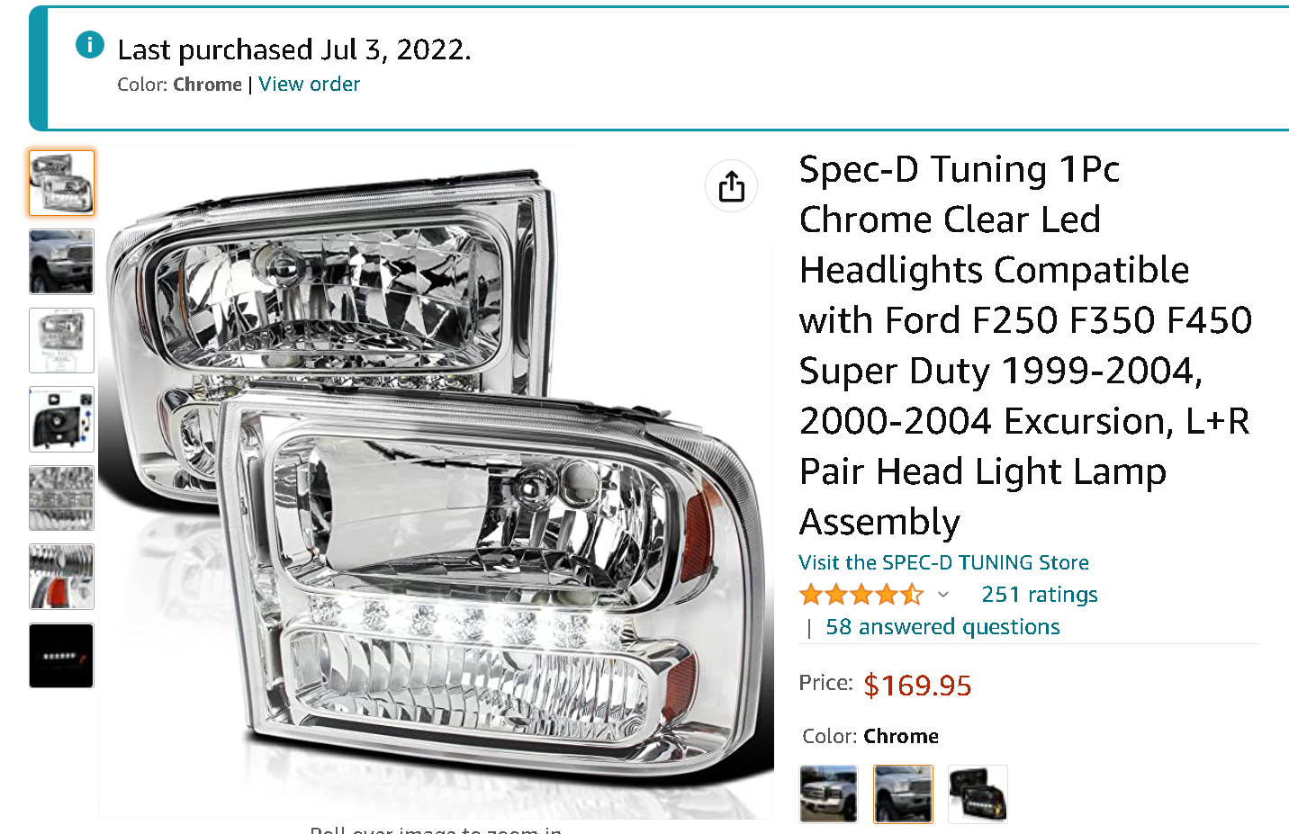

I'm actually installing a pair right now.
2002 f350.
I purchased a no cut conversion light.
I hate to chop up the fiberglass pannel.
They are not as fancy as the cut ones.
But the first went right in with no mod needed.
Most happy
Remember they dont seal them completely and you have to run a bead of clear silicone around or the will get water or fog.
They admit this and advise to fo so in instructions

you can double up on the gasket for a tight seal, thats what i did to mine. Silicone works also. I didnt get these exact ones but did get ones where you had to cut the fiberglass. No regrets and after a year and a half still clear as they came.

Do you have a link to what you bought?
Old Jul 10, 2022 | 07:57 PM
DRPS's Avatar
DRPS
Joined: Jun 2022
Posts: 120
Likes: 12
From: South East
I got these ones...
real clean looking
Make sure to but new clips also

How is the aiming? Those look like a good way to go, except a lot of the reviews say they can't be aimed low enough.
Originally Posted by DRPS
I got these ones...
real clean looking
