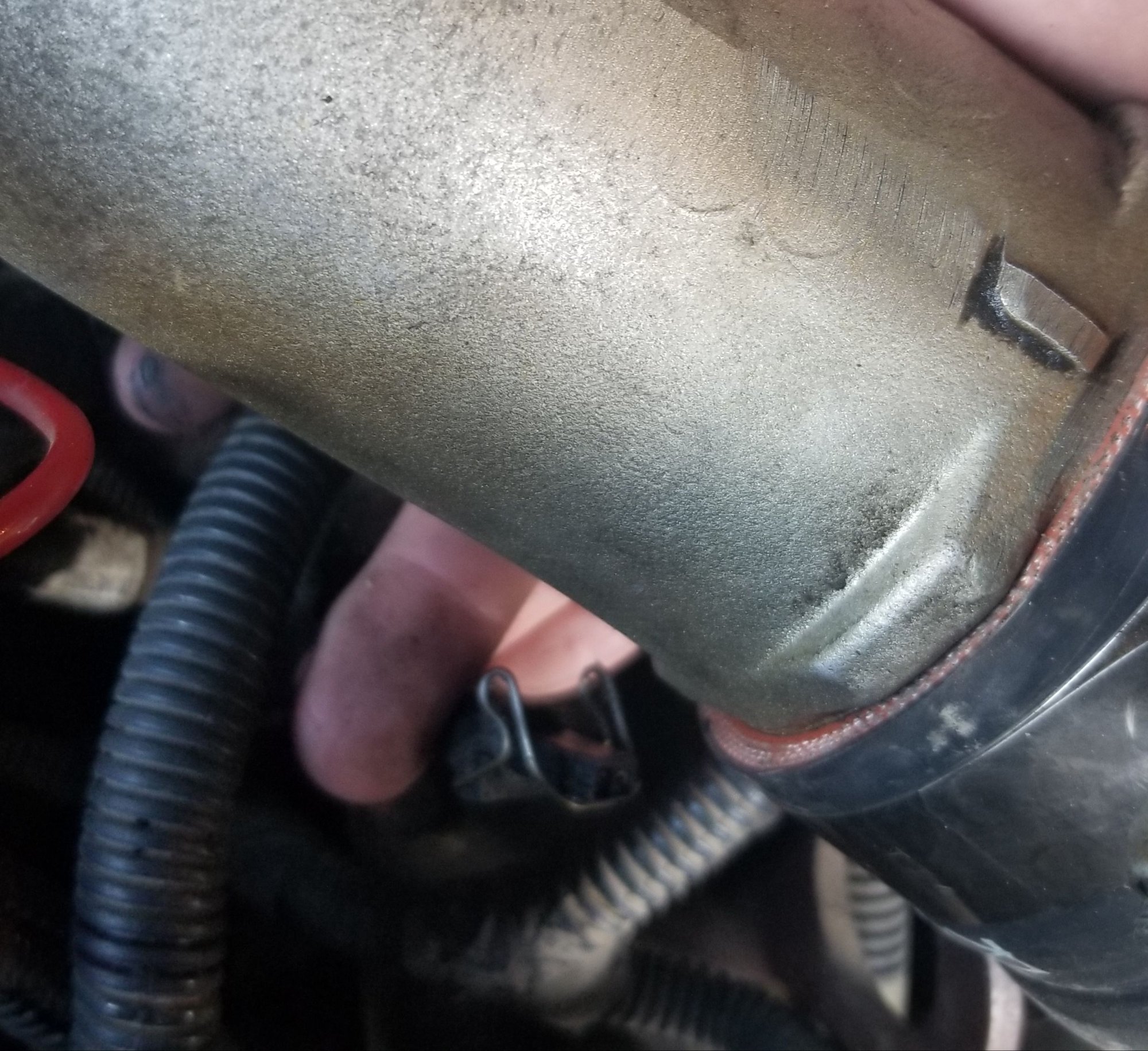

Anyone know where this goes? Rebuilt my turbo and can't find a home for it. First test drive no boost then some boost then none again- related?

Exhaust back pressure valve. It a common thing for people to delete and just tuck the plug out of the way.

I have the ebpv plugged in, weird. Maybe it's extra ha ha.

The IPR has the same connector, but the truck will not run with the IPR unplugged.

I'm starting to think it's been disconnected a long time. Truck is running good again with it still unplugged. Only other plug same shape i found is under the fuel bowl. Thanks for the replies. 👍

Are you sure the ebpv is plugged in? That plug type is on the IPR valve(truck no run without that), ebpv(truck run with soft code), or an injector(you missing a valve cover?)
