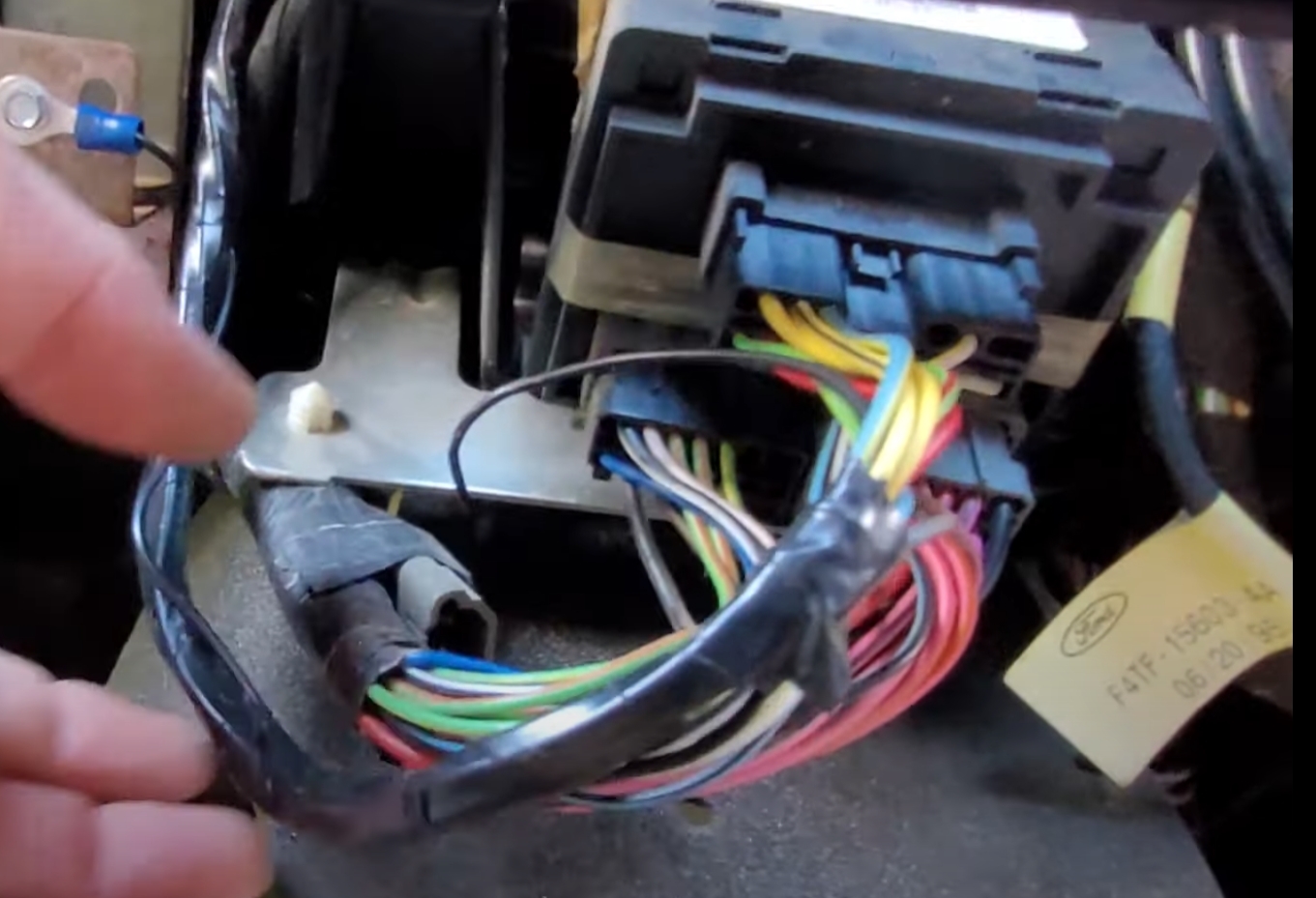

Old Jul 18, 2022 | 02:39 PM
Gary356's Avatar
Gary356
4wd High
Joined: Oct 2021
Posts: 9
Yes, I took a pic of it. I have replaced the headlight switch and saw no evidence of burning, melting, or any problem. It looked almost as clean as the new one.
