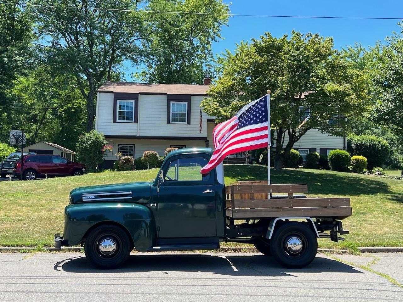

It’s a beautiful 4th of July, I have my flag flying, Bessie gassed up so we took a drive to the barn where we board my daughter’s horse. Ran great, nice winding roads through farmland. Got to the barn where my wife was dropping off the monthly check and while I was sitting idling, she quit. Sudden, like I shut off the ignition.

Can I just say...I love that shot of your truck! I'm sure you got a lot of waves or thumbs up that day...even when you were broken down.
I try to keep the basic "replaceables" in my truck when I take it out. Before you know it, you'll need the entire bed for the spares, lol
As Abe said, the condensers they make today are pure garbage. I got two bad ones from Carpenter in rapid succession and just go with the older NAPA ones myself.
Old Jul 8, 2022 | 09:49 AM
Bob Ingram's Avatar
Bob Ingram
Joined: Jun 2020
Posts: 1,907
Likes: 763
From: Hillsborough NJ
Thx, yeah, she wore that flag well.
