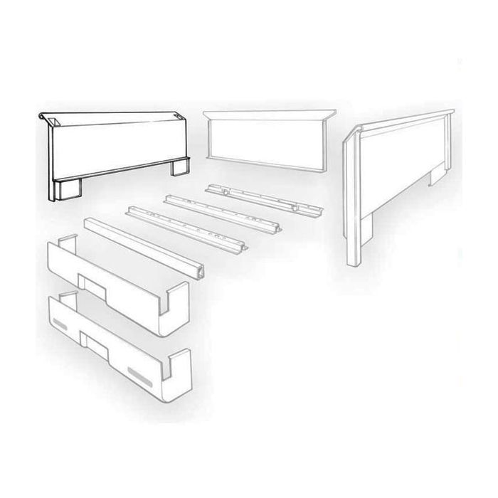

We need to take a little deeper dive into this to really help the OP. It sounds like he has a 55 that needs a bed, and found a 50 bed he wants to use on it. 1950 was a transition year for Ford half ton pickup beds. The early style with the raised panel bed sides have a totally different design and construction from the later beds, identified by the flat panel sides, the style which was used up through the 70's. The early bed has a subframe that the sides and front panel was riveted to, with a metal floor covering over tongue and groove wood boards. The later style was much simpler by design, and the sides essentially sit on crossmembers with exposed wood boards and skid strips. So if we're talking about what the differences are between a 50 bed and a 55 bed, we first need to find out which 50 bed we're talking about. Unless one is experienced in fabrication, trying to make early bedsides work like later ones will be difficult. They're just not made that way.
The late 50 beds (used through 52) are similar to the 53+ sides, but as noted, the bolts for the fenders, which are welded in place, will be all wrong. It will be a lot of work to remove the bolts and then weld up the holes. Doing so will likely warp or damage the panels beyond the point of wanting to use them, if you're looking to do anything nice, and it's going to be a ton of work that may be better spent elsewhere. The other thing that's different is the skirt panels that go between the floor line and the running boards and rear panel. They are a different size to match the length of the fenders. F1 fenders are longer than F100 fenders, so the skirts will be shorter, meaning you'll need to remove them and replace them with the correct parts. Still more work that's un-necessary if you were to start with the vastly more common 53+ sides in the first place.
To Charlie's comment about the frames being 2" narrower, that only applies to the front of the frame from the cab forward. The rear half is the same, standard 34", so the bed will physically interchange. It's just a lot of work to do so. FWIW, my recommendation would be to hold out and find the correct bed and save yourself no end of work and grief, which typically translates to money at the end of the day. Or just get a couple of these for $233 and have all new metal to work with, ready to go. Cheaper and less work than messing with a beat up used bed. Even if the used bed is free and you don't count your labor, the cost of materials to make it work will exceed the buy in for new bedsides.
