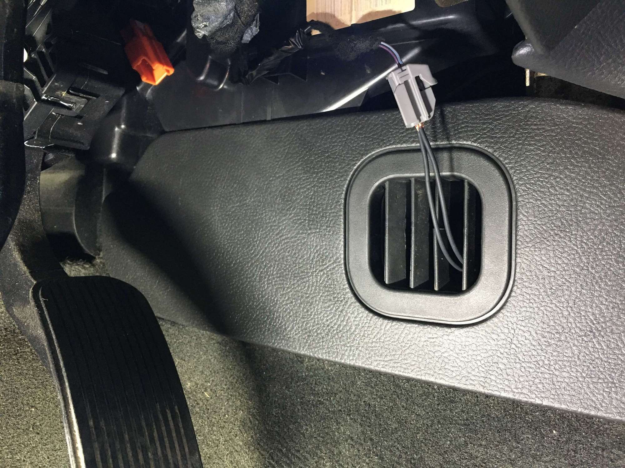

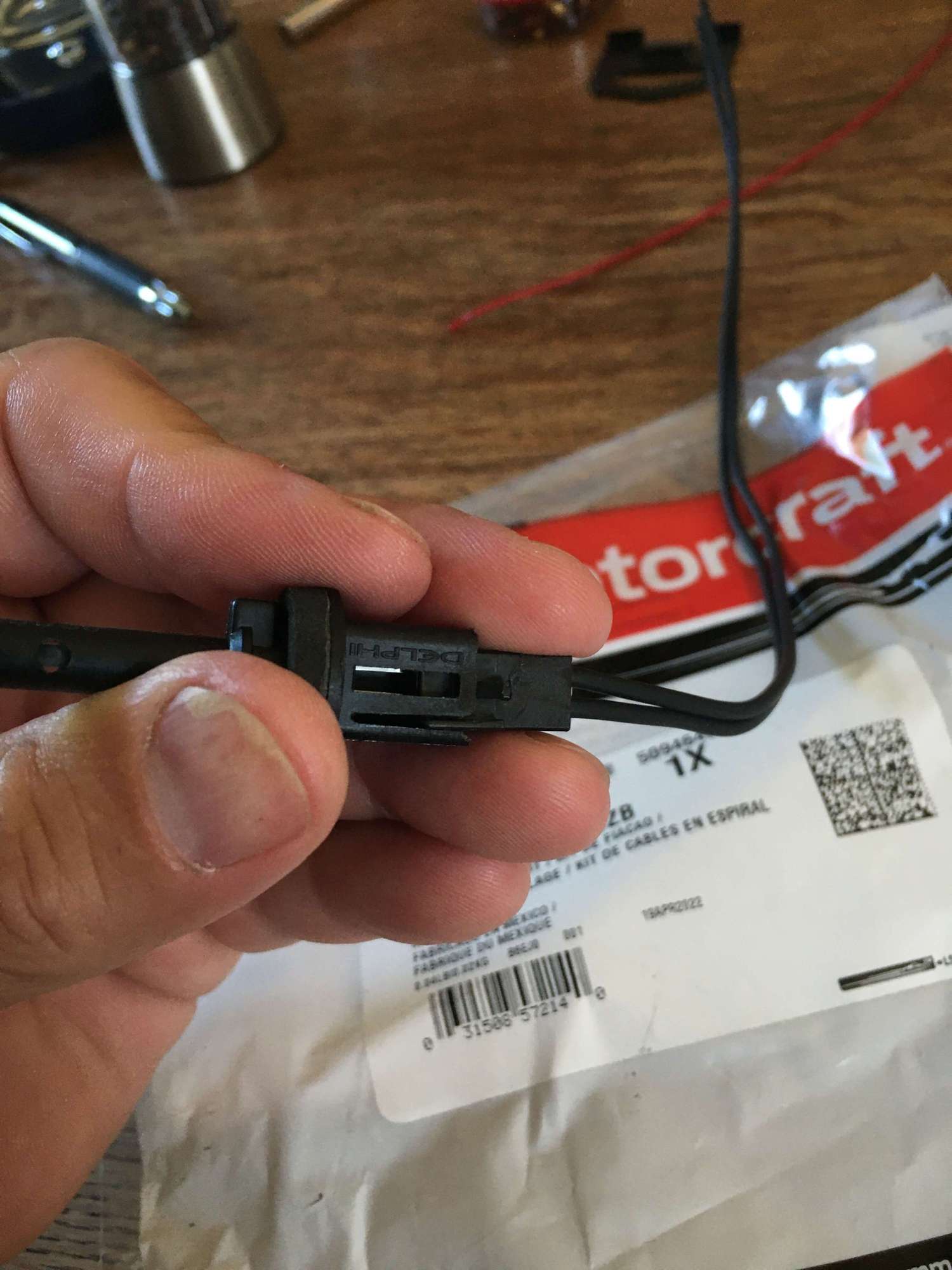

ok so the part arrived and sure enough looks like it will fit!
so just slide the evap sensor over the pigtail lining up the tab on the side....
strip off a little from the end of the pigtail and I poked the ends into the taurus side of the connector just to test it and see that I was reading a correct temp
stuff the evap sensor into the floor vent next to the accelerator
now I drove around with forscan monitoring the "evap sensor temp" and the ACcompressor as I have earlier in the thread. The temp was fluxtuating properly and AC would engange and disengage as expected!!!
Ambient Air was approx 84 degrees and the most problems I have had are in the 90 degree range when the AC dies so I am waiting to see what results I get at higher ambient temps.
But I am VERY hopeful with this workaround. I can see a vent temp within 5 degrees of my manual stick thermometer in the vent and it sweeps lower and higher depending upon selection at the control. I have not had extended testing but will watch it over the next few days. I am hoping we get a 90+ day to give it a good test.
Once I am satisfied with the repair I will add a zip tie to hold the sensor in the vent and I will cut the pigtail off the other sensor I bought and tidy up the wires a bit to make it pretty.

Looks promising!!!!
Since the new sensor isn't in the "ideal" location, I wouldn't expect it to perform exactly the same. Sounds like "pretty close" *might* be good enough!

Short answer yes it works!
there are a couple slight issues in particular temperature ranges where you’ve got to manually turn off or on the AC and make it work.
resistor no longer needed.
I have meant to post a final picture of what I did, and just never got around to it. I will do that hopefully the next few days and get it up here.
