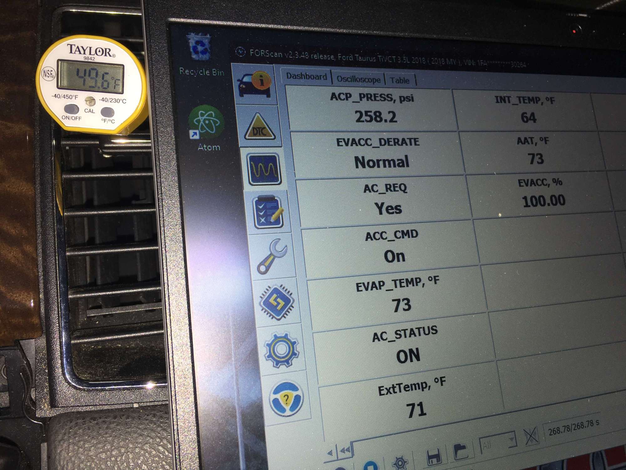

ok decided to do some after dinner testing...
Vehicle sat for probably 4 hours. I started it and let it run for a couple min then tapped max AC
Ambient 80 degrees, 51 degrees out the VENT!!!! This is the best I have seen. and it felt cold in the cabin after a few minutes.
So I let it run in the drive for 20 minutes. I was monitoring the data and enjoying the cold breeze.
AC continued to blow cold. Ambient air temp dropped to 73 over the same period and the vent temp dropped to 46.
Everything seemed to be running normally and the cabin was comfortable. So I decided to go for a drive...
As soon as I started driving the AC pressure skyrocketed and disabled the compressor. I continued to drive and watched the data. It would rise, disable, slowly regress to normal, and then rise again. vent temp was rising to near 65 degrees. The AC setting was on "auto" 65 degrees... I was wondering if maybe it was limiting because cabin was approaching the desired temp...so I lowered the setting to 60...
pressure continued to rise then fall while driving. All other data appeared to be the same as it was in the driveway except as the pressure increased, the EVACC% PID would drop from 100percent to eventually 0. Then as the pressure reached normal it would rise from 0 back towards 100 percent.
thinking that the cabin temp which had dropped to 64 was causing the computer to disable the compressor I went to max AC. Shortly thereafter, once pressure returned to normal range, compressor engaged and vent temp dropped back down to 49 degrees.
AC continued to run until I reached home and it was comfortable in the cabin.
At the end of testing ambient was in the 71-73 range, evap temp was a stead 73 thanks to the 33k resistor, vent was 49 degrees, and the cabin was a cool 64.
I dont know why it did not work like this in the afternoon when the ambient temp was a warm/hot 85-90. It obviously is working "better" at the warm/cool 70-78 ambient temps this evening. still I wonder why it was cutting out for high pressure this evening.
I will test again in the heat of the day tomorrow. Anything I should try or look for?

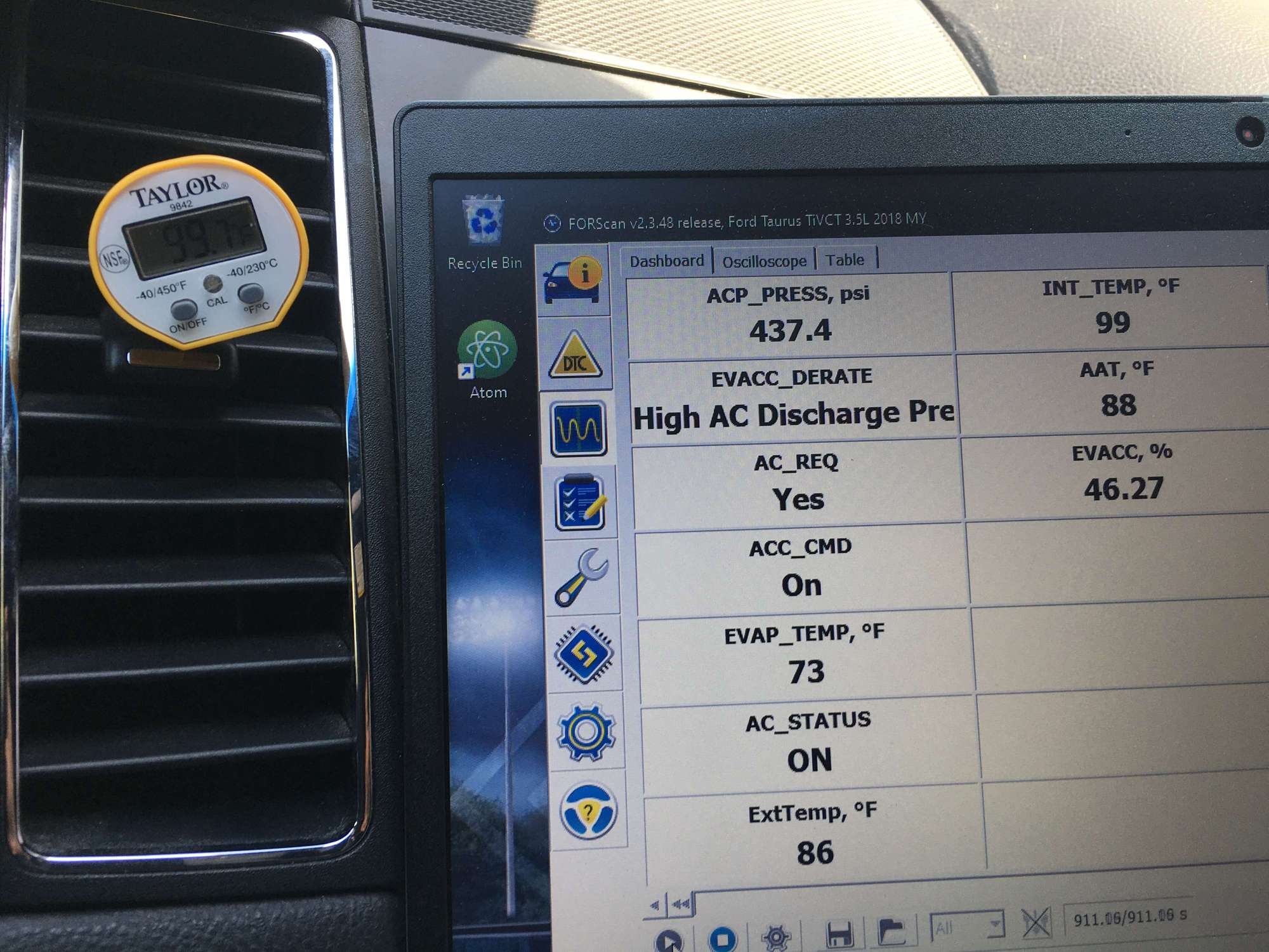

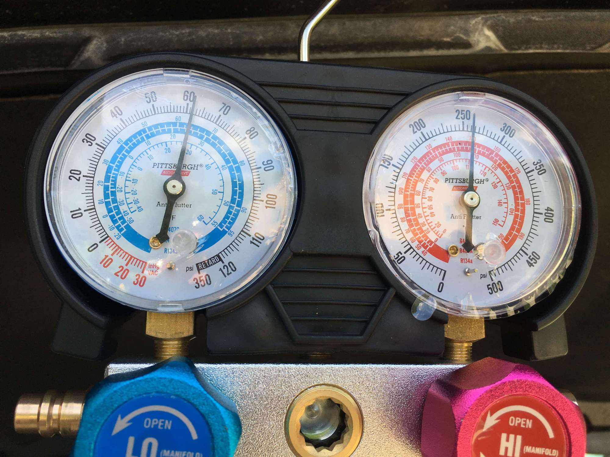

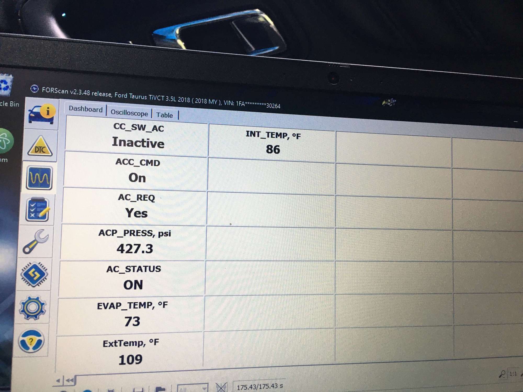

Well I did some testing at lunch...AC not working properly!
ambient temp is 88 degrees.
the AC starts up runs for about 15 seconds, then shuts off because of high pressure. 30 seconds later pressures fall and it starts back up...repeat
when it disables here is a photo of gauges and forscan:
when it starts running again here is what the gauges look like:
So I am getting 100 degrees out of the vents, then the AC engages and it might fall to 75 or so...then right back up.

Regarding the cool morning testing: I've occasionally commented that a marginal system will appear to work normally in mild conditions but it will quickly fail when conditions become harsh. I'd be likely to apply this observation to your car and your testing.
I'm going to refer you to a very good article I came across in a professional periodical while researching your car's issue. Perhaps it will shed light on the subject.
Diagnosing the Ford variable displacement compressor | Vehicle Service Pros
