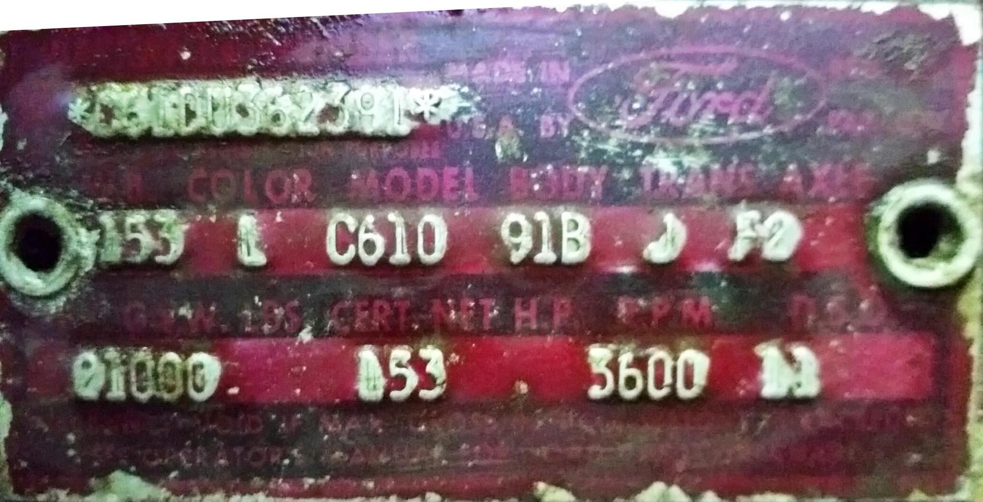

Can someone help me decode this vin tag off of an old ford cabover? thanks in advance

C61 = C600 gas
D = 292 4V HD Ford Y-block gas V8
U = Louisville Assembly Plant
362391 = 1963 serial number, December 1962 production
153 = 153 inch wheelbase
L = Dark Green. Looks like a repaint or two on your truck.
C610 = C600 gas, 21,000 lbs GVWR
91B = I do not have upholstery info but this should be a "Tilt Cab--Custom" cab.
J = Clark model 250V five speed direct transmission
F2 = Two speed rear axle, probably Eaton, 15,000 lbs capacity, 6.33/8.81 ratios
No front axle code--probably for this year only optional axles were listed--'64 to '69 is that way. Figure 6,000 lbs capacity as your GVWR is 21,000 with a 15,000 rear axle.
21000 = 21,000 lbs GVWR
153 3600 = 153 certified net HP @ 3600 RPM.
11 = Boston District Sales Office. Bought "off the lot", no special order showing.
292 with a 5 & 2 was a good combo.
Beware widow maker wheels.
I am going to move you to Large Truck as you will find people who speak C series there.
