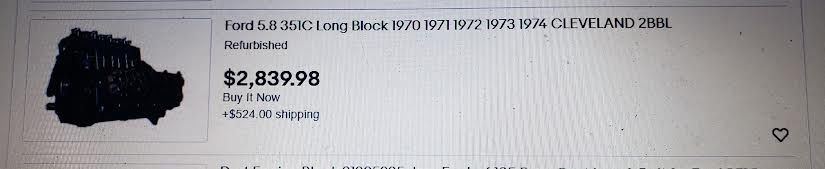

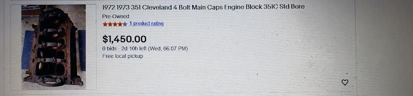

Ebay or the wrecking yards
Rare enough there is only 2 on ebay right now
1 is a auction, the other is a reman 2 bbl most likely a 2 bolt block
Call a wrecking yard with a nationwide locator
You will need Small b big money
I bought a spare Boss 302 motor last year for 8000.00
