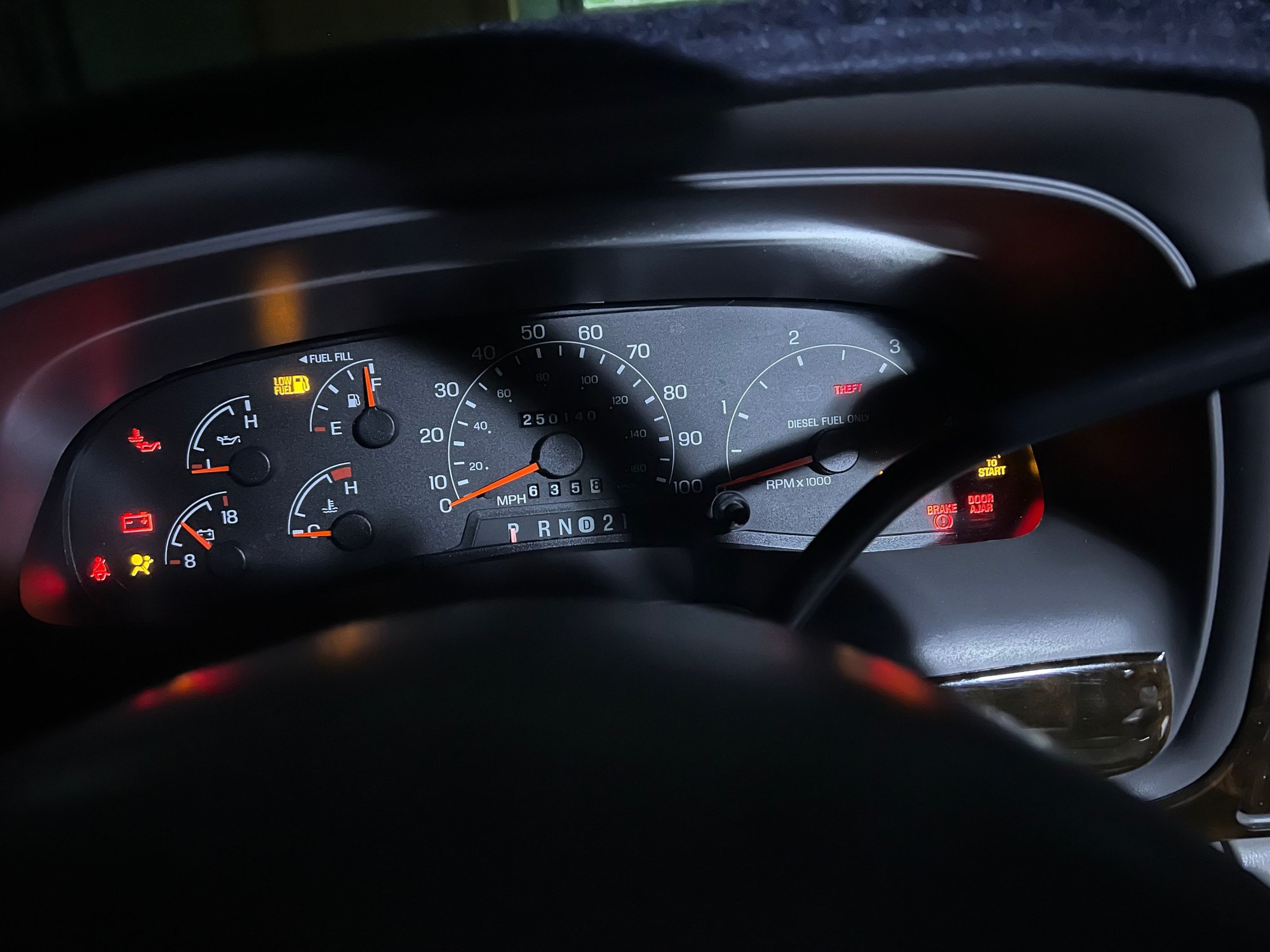

Yes, it's there, mine seldom comes on, because I need to clean the ground tab at the Ebrake pedal assy.
The E Brake light is self checked when you key on, no engine running, or when starting? I never pay attention.

There was only one instrument cluster for the 7.3 used on all 7.3 vehicles. You and I have the same year and engine.
Pics are with key on and brake pedal depressed, & key on and initial systems check.

Our 2002 has the same display.
I should read the owner's manual more thoroughly, the "Brake" light is a dual purpose light - system check and parking brake set.
I rarely use the parking brake and and never paid that much attention to it.
The manual states:
"Brake system warning
Momentarily illuminates when the ignition is turned to the ON position to indicate a system check. Also illuminates if the parking brake is
engaged. If the brake warning lamp does not illuminate at these times, seek service immediately. Illumination after releasing the parking brake
indicates low brake fluid level and the brake system should be inspected immediately."
The switch is right above the pedal bumper which has a single wire so it is probably a circuit grounding wire.
When the parking brake is not set the switch pin is depressed and the circuit is open.
My switch is really flaky so when I work it with my finger the light will flicker on sometimes when the switch is closed-parking brake set.
Sprayed the switch with some WD40 and it is a lot better, but doesn't always turn the light on.
Replacement switches are available - Ford F2UZ15A851A, Standard DS-3398, WVE 1S3606

I confirmed that I do have the brake light in the dash and it does illuminate during startup, but no matter how many times I engage/disengage the E-brake lever, no light. Can someone show me where that silly little switch is, maybe a picture?
